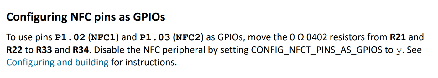

Unable to use NFC1 / NFC2 pins as GPIO on nRF54L15 (Bare-metal SDK)
I am trying to repurpose NFC1 and NFC2 pins for GPIO usage, but they do not function as GPIO, while other GPIO pins work correctly.
  • SDK: nRF Connect Bare-metal SDK v0.9.0-9b7766ff2787
  • Board: nrf-bm/boards/nordic/bm_nrf54l15dk/bm_nrf54l15dk_nrf54l05_cpuapp
What I have tried
  • DeviceTree overlay to disable NFC and use pins as GPIO
&uicr {
nfct-pins-as-gpios;
  • Manually disabling NFCT pads in code
NRF_NFCT_S->PADCONFIG = (NFCT_PADCONFIG_ENABLE_Disabled << NFCT_PADCONFIG_ENABLE_Pos);
Modified the LED sample to use NFC1 / NFC2 pins as output GPIO, but NFC pins do not toggle. Other non-NFC GPIOs work as expected using the same code.
I’ve attached the modified LED sample code below where NFC1/NFC2 are configured as GPIO (other GPIO works fine).
