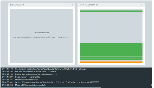

board failed after update mfw_nrf9151-ntn_1.0.0-1.alpha firmware
I Just got nRF9151  SMA board, try to test NTN feature , after following instruction to update so called "alpha" firmware, somehow the board can not reflash back to any vesion,
log as bellow

  • There is my issue
    1. When I done 1.0.0.1.alpha, on the left site orange color on the button still there, after I load lte_modem.hex, that part disapear, and on the board LED1 goes off, an none of way through comport works
    2. I follow Monogoto site for nRf9151 SMA step by step, still fail
    3. And my nRF connect default only 2.0.3 modem core, that is only can bring back the board for AT command
    Any idea?
  • Hi Simon D-M
    thanks for reply,
    yes, I  think I have follow the instruction to do so.
    1. the default firmware I got with the new board  is 2.0.3, which I can "quick start" to rollback.
    2. I download 2.0.2 and unzip it, there is a zip file "mfw_nrf91x1_2.0.2.zip" which I use for "Erase and write"
    3. then I use "mfw_nrf9151-ntn_1.0.0-1.alpha.zip" to "write"

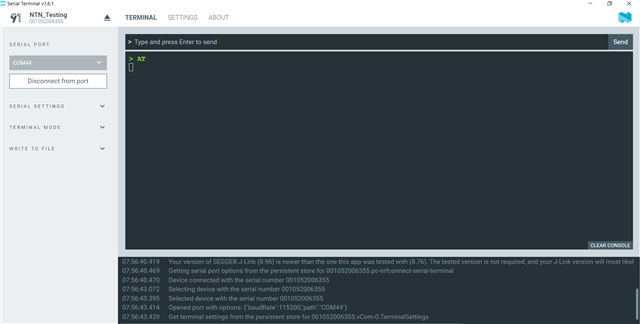

    4. after finish both, things happened as below
    4.1 the LED1 is off
    4.2 and AT command has no respond when I input.
    5. then I use "quick start" to roll back to 2.0.3, LED1 is on, and AT command works find
    and I also found that AT command ver 0.7 vs 1.04 (good for 2.0.3)the parament count are different , on ver 0.7 has 5, but 1.0.4 only 4
    I think this is my problem for now.
    and under 2.0.3, GNSS does not seem getting any number either
    below is screenshot for "write 1.0.1 alpha.zip" and after AT command no respond
    and also if I user teraterm, the input also no respond to any thing.

    If you program the modem with the NTN modem firmware (1.3) you can skip programming the normal cellular firmware (1.1) as the NTN modem firmware is a complete modem firmware and not a patch.
    Also, I would recommend building the "serial modem addon" (previously called "serial lte modem" or "slm") from source to have the latest version. We have a guide on how to do it.
    (1.6) you shouldn't need to type "at_cmd_mode". It should already be ready for AT commands. However, there is a thing to be aware. The AT commands are VERY sensitive to invisible characters. So if a command doesn't work, be sure not to copy-paste it but instead write it from scratch. Also be careful with other serial terminals as they may add some unwanted termination characters that might mess up with the command.
