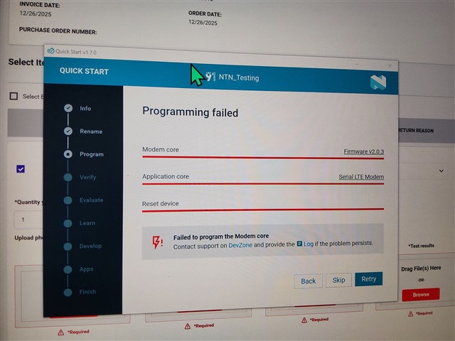

  • Hi Simon D-M,
    I have follow monogoto website, but I think there are a few steps I have got confused
    1. After I program 2.0.2 with zip(after unzip full download from  Nordic,there is an zip I will call that A.zip2. I unzip the full dowanload and use A.zip for "Write" to flash SMA
    2. Look for hex(I was using subdir hex file) to do "Erase and Write", where the bootloader partion disapear(shuold I pick the img subdir hex instaed), apear the booloader portion disapear
    3. Then the board does not activate for AT command
    So are you able to provide me the steps include where should I use the hex and zip file from my download zip 2.0.2 and the alpha zip

    Hi Simon-D-M
    Finally I can complete 2.0.2 modem an Aplication to programm to the kit
    Modem versiom is 2.0.2, but some how not all commands work.
    My steps are
    1. Download 2.0.2
    2. Unzip it,
    3. Open Programmer
    4. Look unzip folder first seen zip file, and "Write"
    5. And then goto xx_bl folder, look for servic,.xxx.hex,this file include bootloader
    6. Add it and "Eraseand write",
    7.I can send at command, but mfm still 2.0.2
    My question is how can I make it 1.0.0.1 alpha, the zip file I dowanload does not contain hex works for fullfucion, or there is steps I am missing here
  • > 1. After I program 2.0.2 with zip(after unzip full download from  Nordic,
    Just to give you some hints:
    "unzip full download"
    Nobody will fully understand, what you did. There are so many "downloads" around the nRF91, that even the "full" in the context of the modem firmware doesn't clear that up.
    If you want to use the nRF9151 A1 for NTN (and TN), you need
    mfw_nrf9151-ntn_1.0.0-1.alpha.zip
    and if you want to rollback to TN (only), you need
    mfw_nrf91x1_2.0.4.zip
    Now: never ever unzip these mfw downloads! Apply them with:
    nrfjprog --verify -r --program mfw_nrf9151-ntn_1.0.0-1.alpha.zip
    or
    nrfjprog --verify -r --program mfw_nrf91x1_2.0.4.zip
    I don't know, how often I did that in the last months (for sure more than 10x, and with several DKs), it was always successful. And never unzipped by me.
    Using the "Programmer App" of the "nRF Connect for PC" works similar:
    - Select your DK with "Select Device".
    - Add either the "mfw_nrf9151-ntn_1.0.0-1.alpha.zip" or the "mfw_nrf91x1_2.0.4.zip" with "Add file"
    The the "Programmer App" will show you the resulting functions, "erase & write" is disabled, "Write" is enabled, so select that. A new dialog "Modem DFU" is shows up, confirm "write" and then wait, it takes a minute or two.
    Also that was always successful, even if I use the "Programmer App" only in rare cases.
  • Hi Achim
    What I see was
    1. When I first power up the board(2.0.3 by default), there are two LEDs light up, one is power LED ,one is LED1. And I can run AT command from rfn connect tool serial command, to check modem version, etc
    2. After I did alpha.zip by  "write", the LED1 went off,and not able to execute at command anymore
    3. After redo v2.0.3 by quict start,
    4. and check at command v0.7 and 1.04
    the 0.7 AT%XSYSTEMMODE=0,0,0,0,1  : 5 parameters
    The 1.04 AT%XSYSTEMMODE=0,0,0,1 : only 4, if I put 5 , it will get error
    This is what I get in past a few days
    FYI, I have NTN sim card activated as well.
