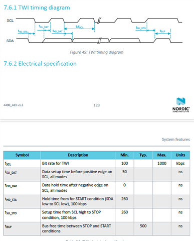

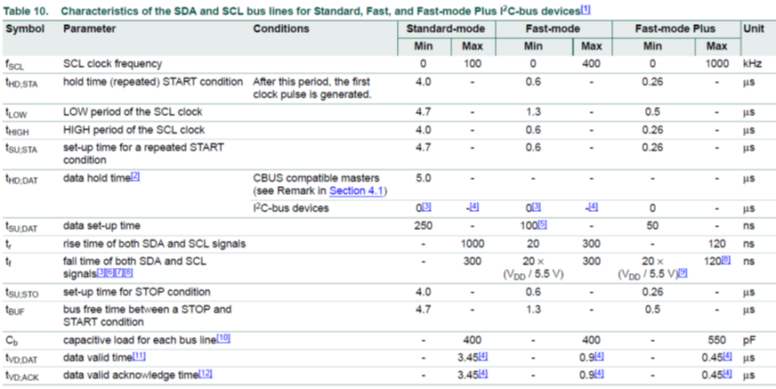

According I2C standard, there is a requirement regarding falling speed of SCL/SDA which is > 20*1.8/5.5=6.54ns, and our measurement result of Tf on SCL is 5.732ns.
I didn’t see this Tf requirement in datasheet of nPM1300
Do you think we can waive this Tf requirement for nPM1300?

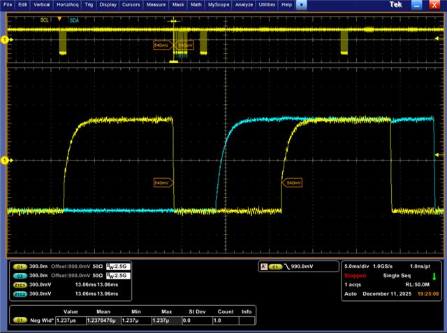

Also Tlow spec. is >1.3us, and our measurement result of Tlow is 1.237us.
I didn’t see this Tlow requirement in datasheet of nPM1300
Do you think we can waive this Tlow requirement for nPM1300?

    Or should we follow I2C standard, Tf need larger than 20*1.8/5.5=6.54ns, Tlow need larger than 1.3us?

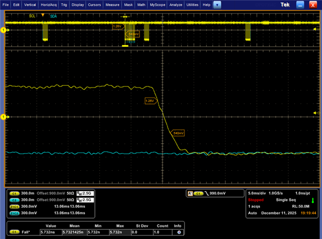

    I agree that according to your measurements it is slightly out of spec (less than 10 %), but would you please let me know how was your measurement procedure? I mean for Tlow did you consider the absolute 0 level duration as low time ? According to the spec , Tlow is the time the signal is below 0.3*VDD.
  • Hi Ressa:
    Yes for Tlow we measure below 0.3*VDD timing, and Tf from 0.7*VDD to 0.3*VDD timing
    Pic. as below
    Tlow
    Tf
  • Hi Poki,
    Thanks for sharing the details. I still think it is not good idea to check the extreme example as we are choosing max speed at fast mode and checking minimum low time. Also considering the clock accuracy and other uncertainties, less than 10 % is not bad and if you don't see any problem with communication over a few hardware samples then no need to worry about that. Also another thing is to measure the accuracy of I2C clock or lets say actual data rate. For example if it is slightly higher than 400 kbps then it will directly translate into shorter "low time".
