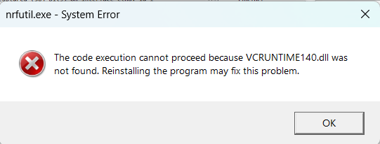

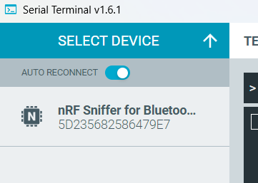

I am attempting to install ble-sniffer onto WireShark for BLE sniffing. I have been following the guide in Link. I have already flashed my nRF52840 USB dongle with the sniffer firmware according to the guide.
# Problem

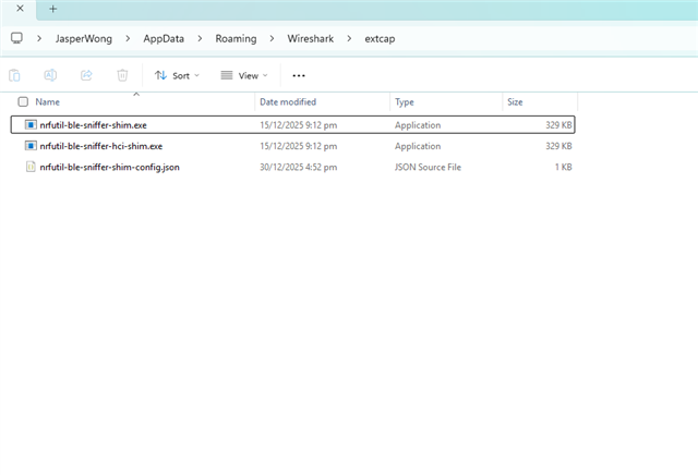

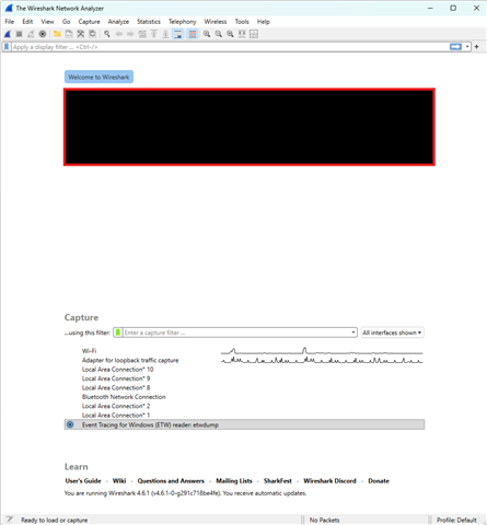

After I ran `nrfutil ble-sniffer bootstrap`, I don't see any new interface appear in the WireShark GUI. I checked that there are two shim executables created and one json file in my WireShark personal extcap folder.
Can I manually install the bootstrap files? What am I missing to sniff on WireGuard?
