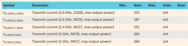

    Indeed, I see that "Table 16: Transmit current consumption (QFN package)" of the nRF7002 datasheet shows:
    So, while some 2.4GHz schemes would allow the nRF7002 to be powered by the nPM1300's buck regulator, others do not.
    However, after further reviewing the nRF7002 datasheet for a better understanding, it appears that the nPM1300 is not required to power the nRF7002? My understanding is now that:
    The nRF7002 has its own Buck regulator that can be used instead of the nPM1300's buck, and it is intended to be supplied directly from the battery via the VBAT pin.
    This would allow me to only use the nPM1300 to power my nRF54, nRF9151, and sensors, and connect the nRF7002 directly to the battery via VBAT. The nRF54 would then turn the nRF7002 and its buck regulator on or off via the BUCK_EN pin.
    Is my understanding correct here? Am I missing any issues? Does powering the nRF7002 "outside" of the nPM1300 cause any issues with fuel gauging, for example?
    EDIT: Or should I connect the nRF7002's VBAT pin to the nPM1300's "pass through" VSYS pin, just like the nRF9151 is meant to be used with the nPM1300, which also has its own internal buck regulator?

    Thanks for the clarification. Using unregulated VSYS for nRF7002 (and other circuits) is possible of course as long as it does not exceed the current limit which is more than 1 A. Supplying nRF7002 directly from battery is also possible but the fuel gauging will not be accurate enough, for accurate fuel gauging all current must pass though PMIC. Using VSYS for powering up nRF7002 with pass through VSYS is better option.
