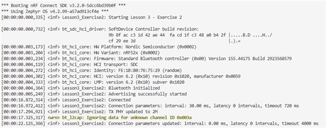

Just a minor flaw in the exercise, but a question concerning the callback from the event “le_param_updated”. In the solution to query the connection interval, it says that “interval” is deprecated.
structbt_conn_infoinfo;
int err = bt_conn_get_info(conn, &info);
double connection_interval = BT_GAP_US_TO_CONN_INTERVAL(info.le.interval) * 1.25;
There is an easy fix for that
double connection_interval = BT_GAP_US_TO_CONN_INTERVAL(info.le.interval_us) * 1.25;
The info.le.interval_us is a uint32_t, whereas the deprecated info.le.interval is a uint16_t. But now in the callback for the event “le_param_update” there is still the deprecated uint16_t interval.
void(struct bt_conn *conn, uint16_t interval, uint16_t latency, uint16_t timeout)
and as far as I saw, the interval in the callback is always 0. I am not sure if that is due to my phone though.
Kind regards, Dani

    Regarding le_param_update callback, could you print out other parameters ? Could you try to test with one of our sample, for example peripheral_power_profiling. Quite strange that you see interval= 0.
  • For the first one, shame on me, I was not on the right tab. I work with SDK v3.2.0.
    Regarding the callback, I can print out other parameters which are not 0.
    I work with an nRF52840dk. Can you suggest another sample that I can run on my board?

    Could you try the attached project (v3.2.0).
    I can see this on my UART log:
    Advertising successfully started
    Connected
    Connection parameter updated
    Connection interval: 1.25 * 6 ms, latency: 0, timeout: 10 * 500 ms
    Connection interval: 1.25 * 24 ms, latency: 0, timeout: 10 * 500 ms
    Connection interval: 1.25 * 24 ms, latency: 0, timeout: 10 * 42 ms
    If you still see the issue with this code, you may need to capture a sniffer trace so we can check what exactly happen over the BLE communication.
