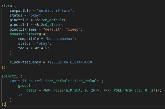

This is my overlay file. The address of the I2C device is 0x14.
&i2c0 {
status = "okay";
pinctrl-0 = <&i2c0_default>;
pinctrl-1 = <&i2c0_sleep>;
bma4xx: bma4xx@14{
compatible = "bosch,bma4xx";
status = "okay";
reg = < 0x14 >;
clock-frequency = <I2C_BITRATE_STANDARD>;

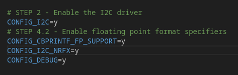

&pinctrl {
/omit-if-no-ref/ i2c0_default: i2c0_default {
group1 {
psels = <NRF_PSEL(TWIM_SDA, 0, 26)>, <NRF_PSEL(TWIM_SCL, 0, 27)>;
