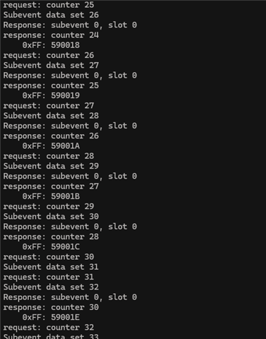

    Update: developer also tested the sample himself:
    Ran the samples on 54L with modifications mentioned in the devzone post. With a sniffer I see the sync consistently responding in the same subevent (response slot delay is 10 ms in the sample, periodic interval is 318.75 ms):
    However, I see the same logs as the customer on the advertiser side:
    So ideally they would use a sniffer to see if the sync is responding in the same periodic interval or not
    I think there are two things confusing here:
    • The controller raises the data request event right after sending the AUX_SYNC_SUBEVENT_IND, before any responses have been received. So the timeline is:
      • Controller sends AUX_SYNC_SUBEVENT_IND with counter=N, requests data for next subevent
      • App responds to data request, sets data with counter=N+1
      • Sync responds with counter=N
      • App receives the response with counter=N
    • The sample prints "Subevent data set N" after it set data with counter=N-1. It is the "request: counter N-1" print that tells which counter value was set.

    We were not able to capture any LE Periodic Advertising packets for some reason (Windows 11, Wireshark 4.6.2, nRF52840 Dongle with sniffer_nrf52dongle_nrf52840_4.1.1.zip) so could not verify the sniffer trace above, but have extended the slot_delay (up to 200ms in another application) which should be sufficient to set a subevent response in the LE Periodic Sync (with subevents) device in the same LE Periodic Advertising interval as the subevent request.
    We greatly appreciate the Nordic developer reproducing our results. And, the following would then explain the results:
    This means the LE Periodic Advertising (with subevents) device will not  be able to send a request based on the previous subevent response from the LE Periodic Sync (with subevents) device in the next LE Periodic Advertising interval after the subevent response is received, but rather must wait for the following LE Periodic Advertising interval to do so.
    Of course this guarantees sufficient time for SD scheduling the next LE Periodic Advertising interval transmission, but reduces the rate of such 'ping pong' transactions by 50%.
    In the LE Periodic Advertising (with subevents) device, would it be at all possible to defer the request for data by the SD controller until after slot_delay time has passed? For sufficiently long LE Periodic Advertising intervals, that should supply sufficient time to process a request.
    Thank you,
    Carl
  • Hi Carl,
    The nordic sniffer does not support PAwR so you will have to use something more powerful like an Ellisys or Frontline sniffer.
    The application does not have to respond directly in the callback from the host (request_cb in the sample). You can call bt_le_per_adv_set_subevent_data later after receiving the response from the sync. If you are too late the controller will respond with an error code (0x46 TOO_LATE).
    Kenneth
    Together with a timer (to handle the case of no response_cb in periodic_adv_rsp sample), this works well.
