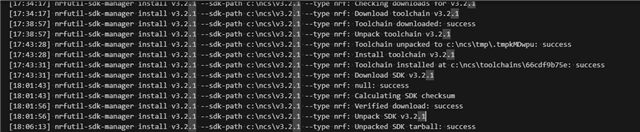

Hei,
I have issues installing this SDK via VS Code Nrf Connect plug in.
The files have been downloaded and unarchived.

Have you tried deleting the remains of the old installation. Please delete tmp and 3.2.0 directory in c:\ncs and try a clean install without any remains of the previous failed installations.
I did that ... similar issues:

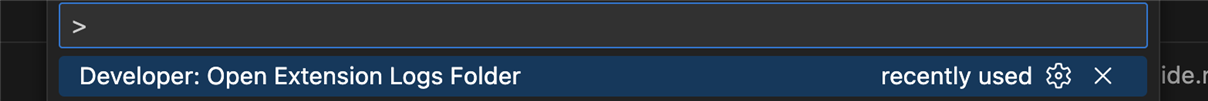

Is there a way to find out what went wrong? Are there some logs kept somewhere?
I am not sure what the issue is then, please find the logs in the folder found in your command palette typing below and provide the relavant logs to us, so that I can forward that to the team.
