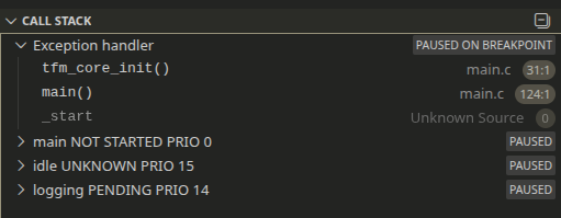

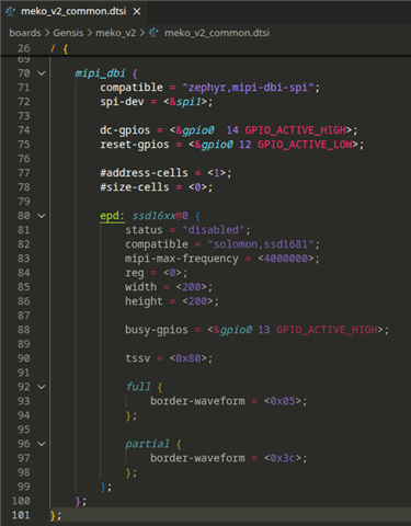

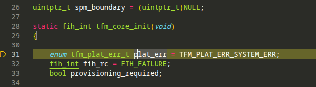

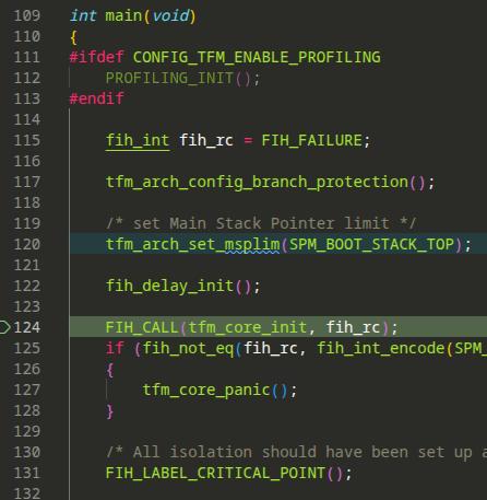

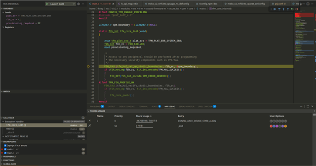

The TF-M core throws an exception when adding an e-ink display to the device tree
I'm planning on using an e-ink display with my custom PCB. But when I add/enable the e-ink display node in my device tree, the TF-M code throws an exception in /ncs/v3.2.1/modules/tee/tf-m/trusted-firmware-m/secure_fw/spm/core/main.c on line 31:
I'm using the /ns target.

    TF-M uses uart1 (which is shared with spi1) for logging purposes:
    https://docs.nordicsemi.com/bundle/ncs-2.7.0/page/nrf/security/tfm.html#building
    Try setting `CONFIG_TFM_LOG_LEVEL_SILENCE=y` and see if the issue still appears.
