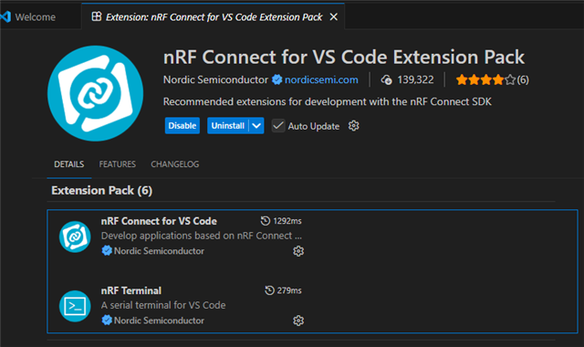

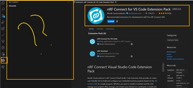

hi I want to use nrf connect sdk using VS code and i want to start my development on this, now i am unable to install this in my windows 11
1. I have installed this nrf connect sdk extension
2. In here this pack install all 6 extensions but when open the extension welcome tab and i found nothing to install

    I just installed VS Code and from within VS Code the nRF Connect for VS Code Extension Pack. I accepted the question about installing the old SDK. Thereafter, I was asked if I wanted to install the segger-tools.
    After a short while I was able to install the SDK and the toolchain without a problem. Already before I installed the segger-tools.
    What I realize is that your screenshot looks different from mine. After installing, I have the possibility not only to uninstall the extension, but I'm also capable of disabling the extension.
    I would try to uninstall the extension, stop VS Code, clean out all the traces of the extension, then restart VS Code and try a new installation of the extension. After installing, it should look like my screenshot.
