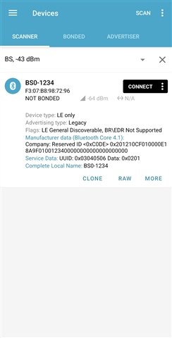

How to use a public address for advertising (nRF54LM20A)?
nRF Connect SDK v3.2.0
Write code:
void bt_ctlr_set_public_addr(const uint8_t *addr)

Log:
[00:00:00.028,603] <wrn> bt_sdc_hci_driver: bt_ctlr_set_public_addr(0x00): 06 05 04 03 02 01
[00:00:02.695,606] <inf> bt_hci_core: No ID address. App must call settings_load()
[00:00:02.703,691] <dbg> bt_settings: set_setting: Name set to BS0-1234
[00:00:02.710,718] <dbg> bt_gatt: db_hash_set: Stored Hash:
						 d4 4c 4d d5 76 eb c7 17 9c bf 01 9b 41 0c a6 66 |.LM.v... ....A..f
[00:00:02.725,754] <dbg> bt_settings: set_setting: ID[0] F3:07:B8:98:72:96 (random)
[00:00:02.733,767] <err> settings: set-value failure. key: bt/irk error(-2)
[00:00:02.741,545] <dbg> bt_settings: commit_settings:
[00:00:02.747,091] <inf> bt_hci_core: HCI transport: SDC
[00:00:02.752,806] <inf> bt_hci_core: Identity: F3:07:B8:98:72:96 (random)
[00:00:02.852,866] <inf> blea: mac addr(ret 1): 01:02:03:04:05:06 (public)
The address seen on the phone is usually not "06 05 04 03 02 01", but sometimes it is "06 05 04 03 02 01", which is very strange.

  • Hi Terje,
    Thank you very much!
    It seems to be caused by CONFIG_BT_PRIVACY=y. Even though I later set it to n, the chip was not erased.
    Best Regards,
    Leo
