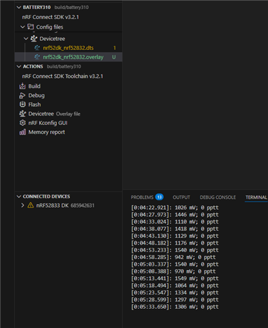

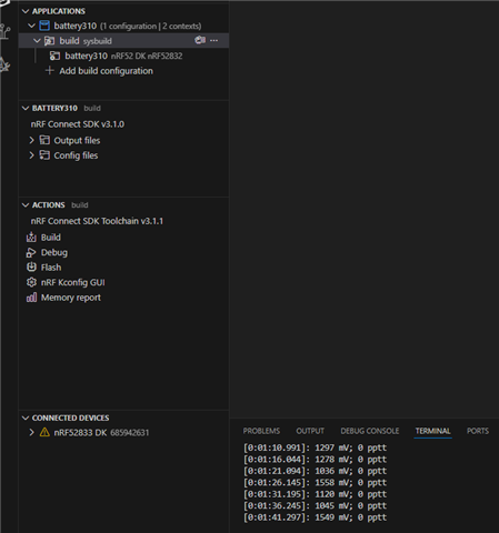

    1. Create a new application that is a copy of the "Measure battery voltage" sample using nRF Connect SDKv3.1.0.
    2. Add the following as the file "nrf52dk_nrf52832.overlay" in the root project directory
        vbatt {
            compatible = "voltage-divider";
            io-channels = <&adc 7>;
            output-ohms = <180000>;
            full-ohms = <(1500000 + 180000)>;
    3. Create a Build Configuration for the board target "nrf52dk/nrf528332", using. SDK v3.1.0 and toolchain v3.1.0.
    4. Build and run that configuration on the nRF52DK and it works - you get this output on the serial port:
    *** Booting nRF Connect SDK v3.1.0-6c6e5b32496e ***
    *** Using Zephyr OS v4.1.99-1612683d4010 ***
    [0:00:00.274]: 1232 mV; 0 pptt
    [0:00:05.265]: 1521 mV; 0 pptt
    [0:00:10.257]: 1138 mV; 0 pptt
    [0:00:15.250]: 1213 mV; 0 pptt
    5. Create another Build Configuration for the same project for board target "nrf52dk/nrf528332", using. SDK v3.2.1 and toolchain v3.2.1
    6. Build and run this second configuration on the nRF52DK and it fails - you get this output on the serial port:
    *** Booting nRF Connect SDK v3.2.1-d8887f6f32df ***
    *** Using Zephyr OS v4.2.99-ec78104f1569 ***
    Failed initialize battery measurement: -2
