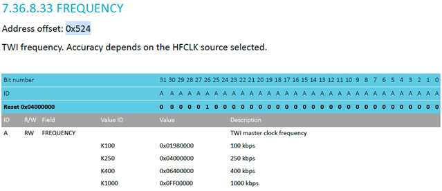

In nRF5340 datasheet I2C frequency only have 4 selection as below

So if we can set I2C frequency to any other value? Or just 100K/250K/400K/1000K can set?

    Only the values listed in the datasheet have been qualified and tested, and should be the ones to use.

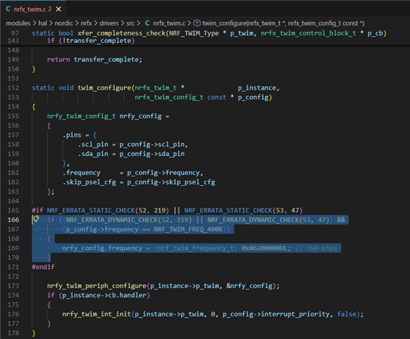

    The only exception is if an errata exists that provide specific workarounds, and in this case (depending on which ncs version you are using), the workaround should be implemented in the low level drivers, for instance when you try to use 400kHz it will apply the errata like this in ncs v3.2.0:
