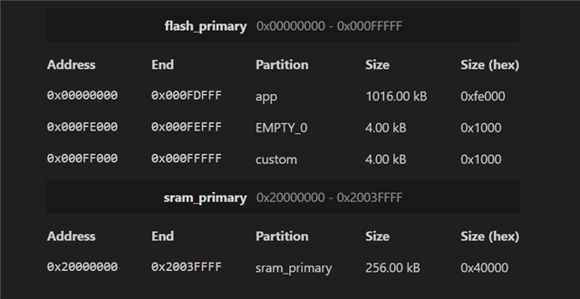

  • Thank you Amanda,
    I did that, yes, it seems to work, the memory report shows the correct partitions:
    My problem now is that I cannot erase or flash section "custom" above, the micro crashes when calling:

  • Ok, I got it running so far. This is what I did, based on several examples:
    pm_static.yml:
    app:
      address: 0x0
      region: flash_primary
    EMPTY_0:
      address: 0xFE000
    custom:
      address: 0xFF000
    sram_primary:
      address: 0x20000000
      end_address: 0x20040000
      region: sram_primary
    Lines added to prj.conf:
    CONFIG_FLASH=y
    CONFIG_NVS=y
    CONFIG_NRFX_NVMC=y
    Now I'm able to use:
    nrfx_nvmc_page_erase(PM_CUSTOM_ADDR);
    nrfx_nvmc_words_write(PM_CUSTOM_ADDR, (uint8_t*)&custom_var, sizeof(custom_var)/4);
    It seems to work well after a few tries.
