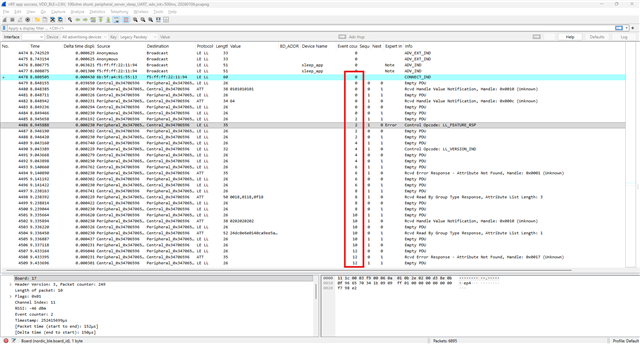

I am using Wireshark with Nordic BLE Sniffer plugin. The sniffer dongle used is nRF52840. I using it to capture a BLE connection from my laptop BLE to a peripheral BLE device.
I observe that the event counter of my BLE communication captured on Wireshark is not incrementing sequentially. I expect that "Event counter" after CONNECT_IND should be 0->1->2->3->..., but I observe that the "Event counter" after CONNECT_IND is 0->2->4->6->8->10->...
May I know why the "Event counter" is not sequentially incrementing?
The screenshot below starts from Packet No. 4478.

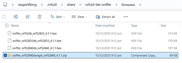

    A few days ago, I updated the sniffer firmware using nrfutil and updated the Wireshark plugins using the nrfutil ble-sniffer bootstrap command.
    The issue:
    The sniffer misses every other connection event. After a fresh firmware flash (using the .hex file provided in this topic via nRF Connect for Desktop), the first connection sniffing session works perfectly. However, for the second and all subsequent sessions, it starts skipping every other connection event again.

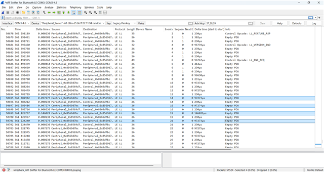

  • Update:
    1. Reflashing the dongle firmware does not always help.
    2. Sometimes, restarting Wireshark and replugging the dongle helps, but not consistently.
    3. Occasionally, I can complete more than one successful trace before the sniffer enters this "weird state."
    4. Once it starts missing every other connection event, it does not recover on its own. Only steps 1 and 2 (reflashing or replugging) provide a temporary fix.
    Environment details:
    • Host OS: Tested on both Windows and macOS.
      Windows wireshark versions 4.6.4 and 4.4.14.
      iOS wireshark version 4.4.1
      Windows nrfutil version 8.1.1
    • Central Devices: Using nRF Connect app on iOS (v2.8.1024) and Android (4.29.1).
    • Peripheral Devices: Based on nRF SDK BLE (s113_nrf52_7.2.0_softdevice, sdk v17.1.0) and a custom BLE implementation (on nRF52).
    • Note: These devices have no connection issues with other centrals; the problem appears to be specific to the sniffer's performance.
  • Update and solution:
    I downgraded Wireshark to the version 3.6 and now the sniffer works properly every time with the latest firmware and Wireshark plugins (v4.1.1).
    It seems that 4.6.4 and 4.4.14 Wireshark versions have an issue.
