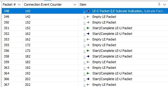

I'm running the subrating sample (ncs\v3.1.1\nrf\samples\bluetooth\subrating) on two nRF54L15-DK boards. Using a protocol analyzer I'm seeing that when the subrate factor is 10, meaning that every 10th connection event can be actively used, only one packet is transmitted and one received. The connection interval is 10 ms and transmission generally takes about 88 us and receiving a packet, only 44 us.
I realise the Bluetooth Core Specification only stipulates that a single packet must be transmitted at least and that anything else is an implementation decision, but is there a way to "encourage" Zephyr to schedule more packets per event than just one each way?
