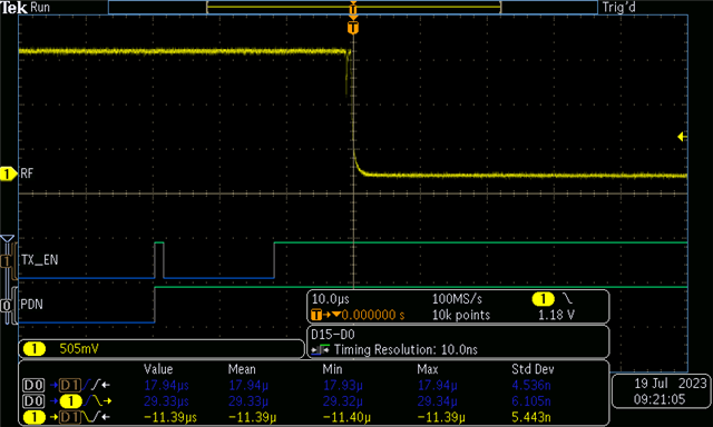

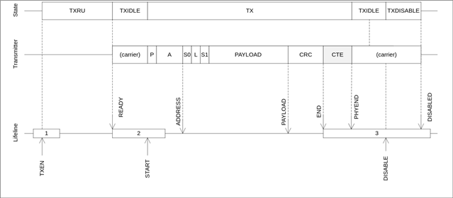

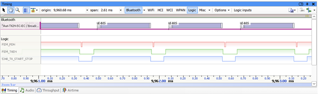

The attached screenshot shows a section of an air-trace for the 5340 running a commercial LE Audio stack. From the rising edge of the logic inputs, it can be seen that the 5340 RADIO_START task is triggered before FEM_TXEN is asserted. This would suggest that there is active RF (maybe unmodulated) being emitted by the 5340 before FEM_TXEN is asserted.
Questions:
  1. Is this timing normal? (I would have expected RADIO_START task to occur after FEM_TXEN is asserted)
  2. How long after the RADIO_START task is triggered does active RF appear on the 5340 ANT pin?
