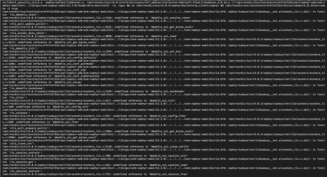

Hi everyone,
I’m facing a linker issue in NCS v3.0.2 while using the Zephyr HTTP client sample with TLS enabled, and I’m looking for guidance on the correct configuration.
Environment
  • NCS version: v3.0.2
  • Board: nRF52 (e.g. nRF52840)
  • Sample: zephyr/samples/net/sockets/http_client
  • TLS: Enabled via sample configuration
  • Toolchain: Zephyr SDK (GCC 12.2.0)
  • Build system: west / sysbuild
Problem Description
I am building the zephyr/samples/net/sockets/http_client sample and enabling TLS support (HTTPS).
When I enable the following configs:
CONFIG_NRF_SECURITY=y
CONFIG_BT=y
the build fails at link time with multiple errors like this: undefined reference to `mbedtls_ssl_config_free'...
All undefined references originate from:
zephyr/subsys/net/lib/sockets/sockets_tls.c
Important Observation
If I disableCONFIG_NRF_SECURITY=y the sample builds successfully.
As soon as CONFIG_NRF_SECURITY=y is enabled (together with CONFIG_BT=y), the linker fails with missing mbedtls_ssl_* symbols.

    Can you describe your setup?
    Which board did you build the sample for?
    Can you show your build configuration, build command and provide complete build log?
    CONFIG_BT=y
    Have you added these Kconfigs manually? Where have you added these options to?
    Dejan
  • I'm building for custom board, it's similar to nrf5340dk.
    Build command: west build -b board_flex/nrf5340/cpuapp samples/net/sockets/http_client --pristine

    Regarding these configs:
    CONFIG_BT=y
    I have not added these Kconfigs manually, these are part of ncs 3.0.2.
    I have made some progress on this, I can now build the project with the above prj.conf. The problem now is that the certificate parsing fails with this error: <err> net_sock_tls: Failed to parse CA certificate, err: -0x2180
    I'm using the same cert provided in the sample code.
    The error code indicates MBEDTLS_ERR_X509_INVALID_FORMAT problem.
    Which certificate is your application trying to parse? What is the location of the certificate?
    Which CA certificate do you use?
    Best regards.
    Dejan
