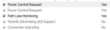

With the following KConfig parameters, I can see that the relevant LL feature bits are set:
CONFIG_BT_TRANSMIT_POWER_CONTROL=y
CONFIG_BT_PATH_LOSS_MONITORING=y
CONFIG_BT_CTLR_TX_PWR_DYNAMIC_CONTROL=y
CONFIG_BT_CTLR_CONN_RSSI=y
But I don't see any APIs that  allow me to initiate procedures that result in LL power requests, response etc being exchanged.
