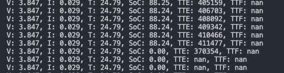

    However, what I have noticed is that sometimes, after flashing the device, the restored SoC goes to zero.
    This has happened while re-flashing the same hex file as was currently running on the device. See step 8 below.
    In this example, the hex file was different (I added a global variable, and incremented it in one function, just to change the memory layout of the code). But I have also observed this phenomenon when re-flashing the same hex file.
    Also, notice that the fuel gauge state buffer contents are the same for step6 and step 8.

  • Hi
    I'm one of the fuel gauge developers, and I have been trying to recreate the issue based on the state memory you have sent.
    Which polarity are you using for the current measurement? Upstream zephyr changed the convention used in the sensor API, such that negative currents is used for battery discharging.The fuel gauge API still treats negative currents as battery charging.
    I have been able to recreate the behavior (soc = 0.00) by using the old convention:
    (initialization and printouts omitted for code clarity)
    /* Fuel gauge initialization done using provided state memory */
    while (true) {
    	voltage = 3.847f;
    	current = 0.029f;
    	temp = 24.79f;
    	delta = 5.0f;
    	soc = nrf_fuel_gauge_process(voltage, current, temp, delta, NULL);
    	k_msleep(100); // Iterate fast to trigger soc=0.00 issue
    If I use the new convention I have not been able to trigger the issue:
    (note the negative current in `nrf_fuel_gauge_process()`
    while (true) {
    	voltage = 3.847f;
    	current = 0.029f;
    	temp = 24.79f;
    	delta = 5.0f;
    	soc = nrf_fuel_gauge_process(voltage, -current, temp, delta, NULL);
    Could this be the problem on your side?
    Audun

    	float voltage;
    	float current;
    	float temp;
    	float soc;
    	float tte;
    	float ttf;
    	float delta;
    	int32_t chg_status;
    	int ret;
        static uint16_t backup_cntr = 0;
        static bool b_first_time = true;
        status_str[0] = '\0';
        ret = read_sensors(charger, &voltage, &current, &temp, &chg_status);
    	if (ret < 0) {
    		printk("Error: Could not read from charger device\n");
    		return ret;
    	/* Zephyr sensor API convention for Gauge current is negative=discharging,
    	 * while nrf_fuel_gauge lib expects the opposite negative=charging
    	current = -current;
        /* Charging active: signed current (negative = charging) */
        bool charging_active = (current < -0.005f);   // -5 mA threshold
        // Update vbus connected
        ret = sensor_attr_get(charger, SENSOR_CHAN_CURRENT, SENSOR_ATTR_UPPER_THRESH, &sens_val);
        if (ret < 0) {
            return false;
    	vbus_connected = (sens_val.val1 != 0) || (sens_val.val2 != 0);
        b_usb_connected = vbus_connected;   // TODO: tidy this up!
        ret = nrf_fuel_gauge_ext_state_update(
    		vbus_connected ? NRF_FUEL_GAUGE_EXT_STATE_INFO_VBUS_CONNECTED
    			       : NRF_FUEL_GAUGE_EXT_STATE_INFO_VBUS_DISCONNECTED,
    		NULL);
    	if (ret < 0) {
    		printk("Error: Could not inform of state\n");
    		return ret;
    	if (chg_status != chg_status_prev) {
    		chg_status_prev = chg_status;
    		ret = charge_status_inform(chg_status);
    		if (ret < 0) {
    			printk("Error: Could not inform of charge status\n");
    			return ret;
    	delta = (float)k_uptime_delta(&ref_time) / 1000.f;
    	tte = nrf_fuel_gauge_tte_get();
    	ttf = nrf_fuel_gauge_ttf_get();
        // Update globals
        battery_charging = charging_active;
        battery_soc = (uint8_t)soc;
        batt_voltage = voltage;
        // Sanity check
        if (b_first_time) {
            b_first_time = false;
            if ((soc == 0.0f) || (soc == 99.0f)) {
                LOG_INF("fuel_gauge_update - re-initialising fuel gauge");
                ret = fuel_gauge_re_init(charger, status_str, status_str_len);
                if (ret < 0) {
                    LOG_ERR("fuel_gauge_update - re-init failed");
                    return ret;
        (void)snprintf(status_str, status_str_len, "dt:%.3f V:%.3f I:%.3f T:%.2f SoC:%.2f TTE:%.0f TTF:%.0f chg:%d st:%d  vbus=%d",
            (double)delta, (double)voltage, (double)current, (double)temp,
            (double)soc, (double)tte, (double)ttf,
            (int)charging_active, (int)chg_status, vbus_connected);
        backup_cntr = (backup_cntr + 1) % BATTERY_SAVE_CNTR;
        if (backup_cntr == 0) {
    	    // Save fuel state data in Flash, every 10 minutes...
            ret = nrf_fuel_gauge_state_get(fuel_gauge_state.fuel_gauge_state_buf, sizeof(fuel_gauge_state.fuel_gauge_state_buf));
            if (ret == 0) {
                fuel_gauge_state.fg_valid = true;
                log_fuel_gauge_state_buffer(fuel_gauge_state.fuel_gauge_state_buf, sizeof(fuel_gauge_state.fuel_gauge_state_buf));
                file_save_fg();
                LOG_INF("FG state saved (size = %d)", sizeof(fuel_gauge_state.fuel_gauge_state_buf));
            } else {
                fuel_gauge_state.fg_valid = false;
                LOG_WRN("FG state_get bad (ret=%d, where 0=success). Not saving.", ret);
    	return 0;
    I don't see any problems with the code, although I have not tried running it yet.
    The `charging_active` boolean looks to be wrong due to the sign change of the current, but this does not look to have any practical implications in this function at least.
    From your previous reply it could be that the issue is due to an incompatibility with the stored state being used in different versions of the fuel gauge library. Could this be the case, or do you see the problem persist even when re-flashing using the same SDK version?
    If you still see the issue I will try running your code and debug further, and I'd like to check the potential version incompatibility of the state structs. You mentioned using SDK 2.9.2, but we did not add the state get/set functionality for fuel gauge until SDK 3.0.0. Did you use a more recent fuel gauge library in your SDK 2.9.2 project, or did I misunderstand the versioning?
    Audun
  • Hi Audun,
    I am using SDK 3.1.1. I use the same application when Flashing. Sometimes, I modify the application slightly (e.g. add one debug global variable). Always SDK 3.1.1.
    When I first posted this ticket I was using SDK 2.9.2, but I then upgraded to SDK 3.1.1 to use the nrf_fuel_gauge_state_get() function.
  • Thanks for the details,
    I do have one more theory of what could have gone wrong. The state blob includes a pointer to the battery model. If this is no longer valid after you have changed the binary, the behavior would change.
    Can you try to update the pointer within the binary blob before passing it on to nrf_fuel_gauge_init()? I assume you have the data in RAM already.
    #include <zephyr/sys/byteorder.h>
    sys_put_le32(&battery_model, &fuel_gauge_state.fuel_gauge_state_buf[224]);
    This API needs to be updated on our side to allow the battery model to be moved around. It's inconvenient to require this pointer to be static across firmware updates.
    Audun
