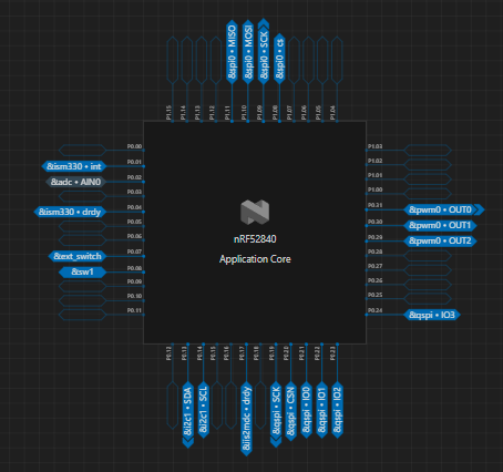

I have a custom PCB that I am programming. The PCB uses a NRF52840-QFAA chip. I want to save a file inside of the external flash chip (W25Q256JVEIQ). It is connected using QSPI. I have created the device tree, the prj.conf, the pm_static.yml, and the main.c files. However, every time I run the code I get this error.
I was able to configure the external flash using partition manager but cant seem to read or write files inside the flash.
I have attached my files below. Can anyone help me with this? Even after resetting the chip it fails to mount.
Do I have to erase the external flash completely? How do I solve this?

  • I reviewed that post and ran the command "nrfjprog --family NRF52 --qspieraseall" however it failed to initiate the QSPI peripheral.
    I noticed in my hardware that I am missing a pullup on the CS line. Could that be the issue with the external flash?
    I tried adding it in software but it doesnt seem to do anything. I shouldve noticed that the datasheet states this

    Is there a way to configure this in the code so that CS can be turned on and off? Or is a pullup required?
