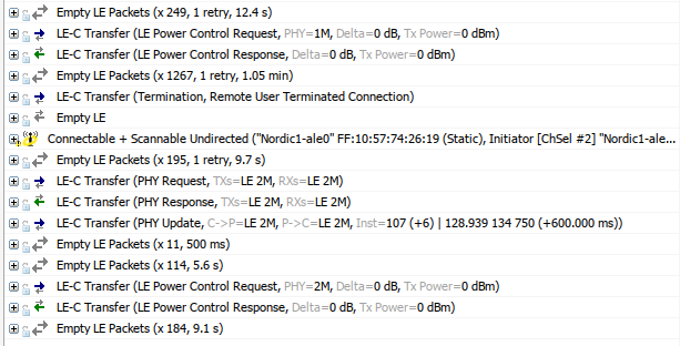

Set TX Power Reporting Enable has no discernible effect
I'm sending HCI command LE Set Transmit Power Reporting Enable with both local and remote reporting requested.
The Bluetooth Core Specification says "If the Remote_Enable parameter is set to 0x01 and no prior LE Power Control Request procedure has been initiated on the ACL connection, then the Controller shall initiate a new LE Power Control Request procedure (LL5.1.17) on that ACL".
The Power Control Request procedure says "The Link Layer initiates this procedure by sending an LL_POWER_CONTROL_REQ PDU".
But I see no power control PDUs exchanged.
Here's my code, which I call once after establishing the connection:

The command is working because I see this in the console:
set_tx_power_reporting_enable: HCI command OK

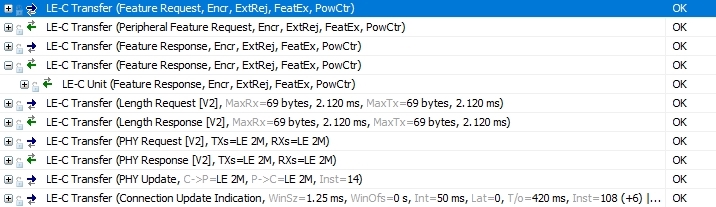

I see various control PDUs exchanged including feature request/response pairs and the features reported as being supported include Power Control Request and Path Loss Monitoring.
But no LL_POWER_CONTROL_REQ or LL_POWER_CONTROL_RSP.
I'm testing on a pair of nRD54L15-DK boards. AFAIK power control is supported.... at least the controller is reporting this to be the case.
Hope someone can share some wisdom on this.
Thank you in anticipation.
