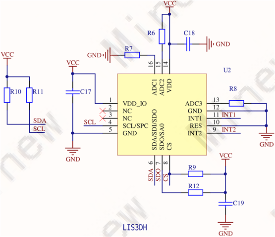

Hello, I am using the LIS2DH sample (and the st,lis2dh driver, which is compatible with the LIS3DH accelerometer) to test out a LIS3DH IC attached to a custom board. However I keep getting the following error:
SEGGER J-Link V8.96 - Real time terminal output
SEGGER J-Link V12.0, SN=822000525
Process: JLinkExe
[00:00:00.265,258] <err> lis2dh: Failed to read chip id.
*** Booting nRF Connect SDK v3.2.1-d8887f6f32df ***
*** Using Zephyr OS v4.2.99-ec78104f1569 ***
Device LIS3DH is not ready

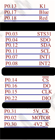

In our board (snippets from the schematic attached), the SDA and SCL lines are wired to GPIO P0.12 and P0.11 respectively. INT1, INT2 are wired to P0.07 and P0.08. SD0 is connected to P0.04. CS' is pulled high and I am not asserting it because he datasheet says that it must be tied high for I2C.

based on a similar problem posed in another ticket I have added a reset command in the block where the device driver is not ready. The user reported that this approach worked for him but it keeps on failing in a loop for me.
If there is anything wrong that stands out in the above snippets, it would be great to know. Thank you for your time!
  • Try changing the irq-gpios to e.g. 26 and 27, to see if it makes a difference. If you are currently using UART logging, then the pins 07 and 08 is used by the UART. You can see on the back of the DK what pins that are used by default.
    Edvin
  • Hi Edvin, thank you for the response. I am not using UART for logging because our board doesnt have UART pins exposed (and power consumption reasons) - only SWD pins so we use RTT for all our logging. I made the changes that you mentioned but I'm the same result as before. I could share the schematic for the LIS3DH itself if you want to have a look.
  • Ok. It was worth a shot. Did you disable the UART logging? (It will be on by default).
    If yes, have you tried scoping the I2C lines to see if there is any traffic, or if it fails before that?
    You are not able to reproduce this on a DK? Do you have a breakout board for the lis2dh?
    Edvin
  • Hi thank you for your patience. UART logging was disabled. We might need to examine the I2C lines. We are thinking of procuring a separate breakout board and testing it out on a DK. Will keep you posted.
    Also, if I am not mistaken the wiring provided can also be used with SPI?
