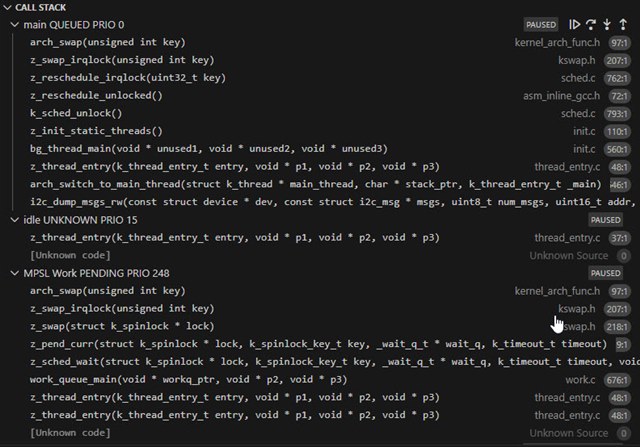

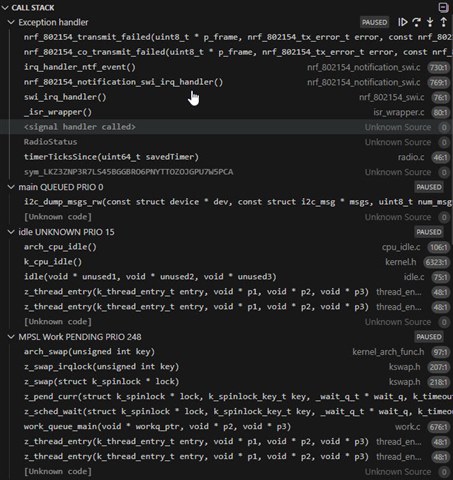

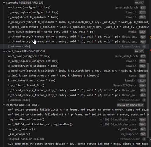

  • I decided to capture the call stack for my other errors in case it helps you help me - so I turned  the temperature config back off. I found that I am still occasionally getting a false response to
    nrf_802154_transmit_raw in addition to hitting
    nrf_802154_transmit_failed - I said previously that I wasn't getting that first one anymore but apparently that was incorrect.
    Screenshots for nrf_802154_transmit_raw  returning false:
    Screenshots for nrf_802154_transmit_failed:

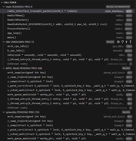

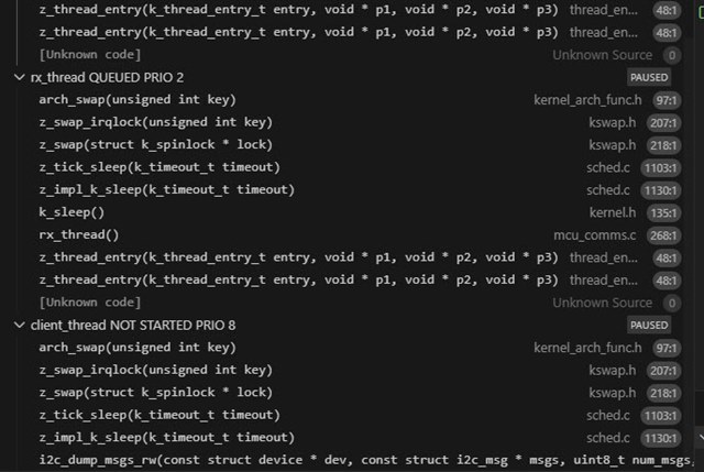

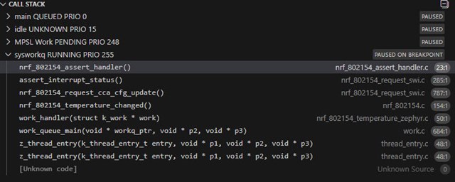

  • Hi Elfving,
    I've done some rewriting to make my code look more like the 802.15.4 phy test example, with workqueues etc. It seems like i'm getting fewer errors, and with improved debug prints I know more about the kinds of errors I'm getting (mostly NRF_802154_TX_ERROR_NO_ACK and NRF_802154_TX_ERROR_ABORTED 0x06).
    I'm letting it run overnight to see how many errors I get and to collect a new debug log, but in the meantime I've attached the two relevant radio files I'm using to send and receive data. Can you please code-review them and just see if it looks like I'm doing everything properly with regards to the radio?
