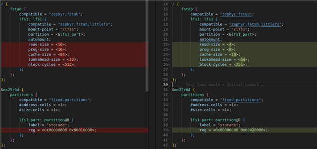

  • Hi Dejan,
    All of the images that I'm running below were built with sysbuild.
    The values I changed were in the fstab entry of the device tree.  I made a change to them to see if the image was using those values from the device tree or was getting them from somewhere else.
    When I boot an image from the nordic_suggestions.3.2.1 branch built with NCS 2.7.0:
    I: LittleFS version 2.8, disk version 2.1
    I: FS at mx25r6435f@0:0x0 is 16 0x1000-byte blocks with 512 cycle
    I: sizes: rd 16 ; pr 16 ; ca 64 ; la 32
    I: Automount /lfs1 succeeded
    *** Booting nRF Connect SDK v2.7.0-5cb85570ca43 ***
    16 0x1000-byte: second value of reg entry for the partition (0x00010000)
    block-cycles: 512 cycle
    rd (read-size): 16
    pr (prog-size): 16
    ca (cache-size): 64
    la (lookahead-size): 32
    If I modify those values as shown below and rebuild with NCS 2.7.0.:
    I get the following output:
    I: FS at mx25r6435f@0:0x0 is 32 0x1000-byte blocks with 512 cycle
    I: sizes: rd 4 ; pr 8 ; ca 16 ; la 64
    So we can see that all of the values were updated in the output except for the block-cycles, that still stayed at 512 even though I tried to set it to 256.
    The size of the file system also changed from 16 0x1000 byte blocks to 32 blocks following the change of the value of the reg entry in the partition table for the 'lfs1_part' entry.
    Now, if I build with NCS 2.8.0:
    I: LittleFS version 2.9, disk version 2.1
    I: FS at mx25r6435f@0:0x0 is 6 0x1000-byte blocks with 512 cycle
    *** Booting nRF Connect SDK v2.8.0-a2386bfc8401 ***
    The changed values in the fstab entry are still changed in this output (except for the block-cycles) however, the file system size is now 6 0x1000 byte blocks and not the 32 0x1000 byte blocks specified in the 'lfs1_part' entry of the device tree.
    If I build with NCS 3.2.1:
    I: LittleFS version 2.11, disk version 2.1
    I: FS at mx25r6435f@0:0x0 is 6 0x1000-byte blocks with 256 cycle
    I: partition sizes: rd 4 ; pr 8 ; ca 16 ; la 64
    *** Booting nRF Connect SDK v3.2.1-d8887f6f32df ***
    Now everything (including block-cycles) has changed to match the device tree fstab values except for the size of the partition.  I assume that the block-cycle not changing was a bug that was fixed at some point.
    What I'm not understanding is how to configure the partitions and fstab entries when using a NCS that is 2.8.0 or newer.
    If I remove the 'partition' entry in fstab, I get the following error when trying to build in NCS 3.2.1:
    -- Found devicetree overlay: /home/jeffc/projects/test/littlefs/boards/nrf52840dk_nrf52840.overlay
    devicetree error: 'partition' is marked as required in 'properties:' in /home/jeffc/ncs/v3.2.1/zephyr/dts/bindings/fs/zephyr,fstab,littlefs.yaml, but does not appear in <Node /fstab/lfs1 in /home/jeffc/projects/test/littlefs/boards/nrf52840dk_nrf52840.overlay:17>
    So, it appears that I need a partition entry in fstab to point at something in the devicetree, but the information in it isn't being used.
    If I need to create a 'pm_static.yml' to define my partitions for the partition manager, how does that relate to the device tree fstab entries?
    thanks,
    Jeff
