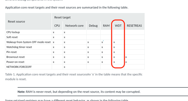

    The bootloader does not start the watchdog. The feeding mechanism is there to feed the watchdog if it has been started by the application (WDT state is retained through a soft rest , see Application core reset behavior)
    Vidar
  • Thanks for the quick reply Vidar.
    I've just checked the application and it indeed does call `wdt_install_timeout()` as well as `wdt_setup()` via Zephyr's task watchdog API.
    I read out the value of the CRV register and it was indeed updated. I also called `nrf_wdt_started_check()` in the app's main.c to check if the watchdog has actually been started, and the function call did return true.
    However, when I called `nrf_wdt_started_check()` in `mcuboot/boot/zephyr/main.c`, it returned false. I also got 0xFFFFFFFF when trying to read out the value of the CRV register in mcuboot's main.c.
    Maybe I'm just not using the watchdog API correctly? I'm building the firmware using sysbuild, just FYI.
  • While reading the WDT state from the bootloader, please also check the RESETREAS to confirm the reset source (Note: this register is retained across all resets but POR/BOR).
  • So I've injected some code into mcuboot's main.c to read out RESETREAS. Throughout DFU, there were 3 reboots in total (not sure why).
    - 1st reboot, reset reason: watchdog and software
    - 2nd reboot, reset reason: software
    - 3rd reboot, (after which the app starts to run): reset reason: power-on reset

  • I tested with SDK v3.1.1 using a slightly modified version of the Zephyr SMP server sample (added starting of the WDT). I also changed the bootloader to print the WDT status and reset reason on boot.
    Bootloader changes:

    Log (initial boot after programming + 1 FW update followed by reboot to activate new FW)
    *** Booting MCUboot v2.1.0-dev-9b4ae4cbc9e2 ***
    *** Using nRF Connect SDK v3.1.1-e2a97fe2578a ***
    *** Using Zephyr OS v4.1.99-ff8f0c579eeb ***
    I: WDT is disabled
    I: Calling MCUBOOT_WATCHDOG_FEED
    I: Starting bootloader
    I: Reset reason: PIN reset

    I: WDT is active
    I: Reset reason: software
    I: Image index: 0, Swap type: perm
    I: Image index: 1, Swap type: none
    I: Image 0 upgrade secondary slot -> primary slot
    I: Erasing the primary slot

  • Thanks a lot for the test. I also did some more digging into my application and found out that when `TASK_WDT_HW_FALLBACK_DELAY` and `TASK_WDT_MIN_TIMEOUT` were set too low (i.e. to 100), the watchdog kicked in almost right after the image upgrade was scheduled. I could then see that the reboot reason was "watchdog | software" instead of just "software", and that the value of the CRV register was reset to 0xFFFFFFFF.
    Leaving `TASK_WDT_HW_FALLBACK_DELAY` and `TASK_WDT_MIN_TIMEOUT` with their default values fixed that, and now I can see that the reset reason read out during mcuboot is now the same as in your log. So I'd say the watchdog behaves exactly as documented.
    I still haven't been able to figure out yet why my device reboots multiple times during DFU, but I believe it has something to do with my application and not nrf/zephyr.
  • Thank you for the update. Yes, if the WDT is configured with a too short timeout (I'm not sure what the exact min. is), the bootloader WD feed mechanism will not be able to reload the WDT in time. Thank you for reporting back what the problem was.
