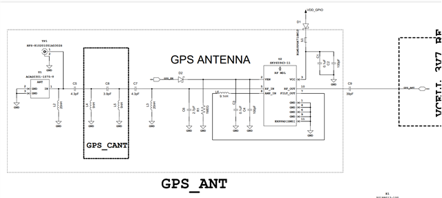

I am trying to implement GPS code.
I am trying to implement GPS code in the nrf9160 but I cant find the function nrf_modem_gnss_init(); to initialize GNSS inside the modem in , is it being initialised within nrf_modem_gnss_start() function internally ?   please help on this.

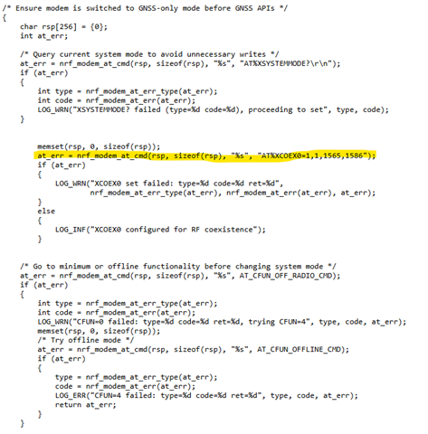

    It looks like it was removed in modem lib v1.4.0; https://github.com/nrfconnect/sdk-nrfxlib/blob/ae711ee48f137daccae54a67387a336eceff197f/nrf_modem/doc/CHANGELOG.rst#nrf_modem-140
    I believe you can achieve the same thing by running nrf_modem_init() and nrf_modem_gnss_start().
  • I tried to init the modem with AT commands and then used nrf_modem_gnss_start. Once the handler gets registered and the
            /* Start GNSS */
            err = nrf_modem_gnss_start();
    In the logs I am getting sv_view as 0 or 1
    Sharing the logs below for your reference.

    [00:00:26.488,250] <27>[0m<inf> gnss_app: GPS powered ON<27>[0m<\r><\n>

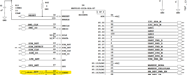

    [00:00:45.792,175] <27>[0m<inf> gnss_app: Modem set to GNSS-only mode<27>[0m<\r><\n>

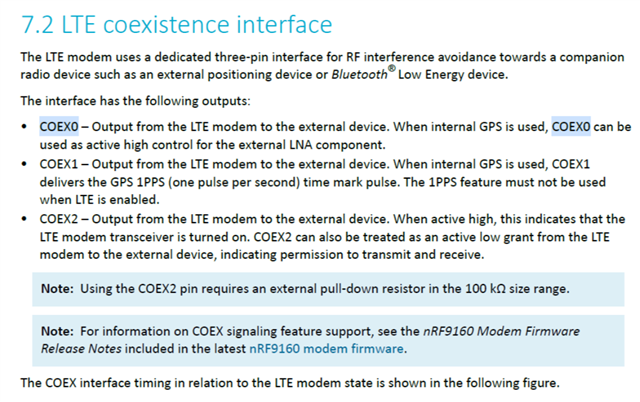

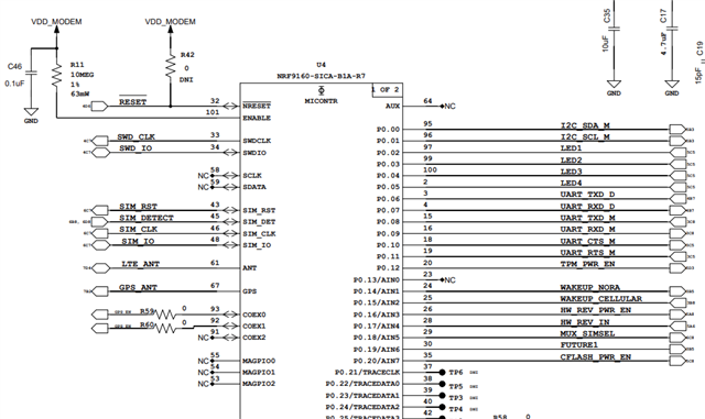

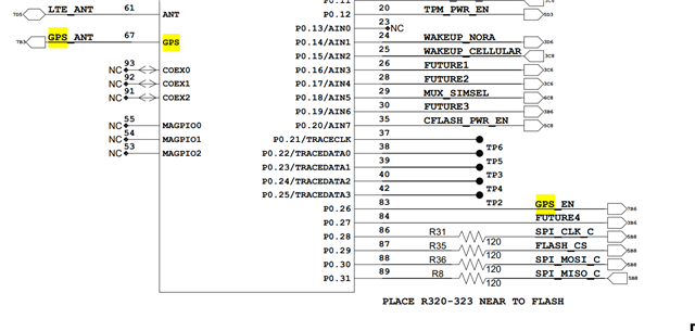

    [00:00:47.986,694] <27>[0m<inf> gnss_app: Skipping XMAGPIO/XCOEX0: pins not connected on this board<27>[0m<\r><\n>

                at_err = nrf_modem_at_cmd(rsp, sizeof(rsp), "%s", "AT%XMAGPIO=1,1,1,7,0,0");
                if (at_err)
                    LOG_WRN("XMAGPIO set failed: type=%d code=%d ret=%d",
                            nrf_modem_at_err_type(at_err), nrf_modem_at_err(at_err), at_err);
                else
                    LOG_INF("XMAGPIO configured for GNSS antenna/LNA");
                memset(rsp, 0, sizeof(rsp));
                at_err = nrf_modem_at_cmd(rsp, sizeof(rsp), "%s", "AT%XCOEX0=1,1,0");
                if (at_err)
                    LOG_WRN("XCOEX0 set failed: type=%d code=%d ret=%d",
                else
                    LOG_INF("XCOEX0 configured for RF coexistence");

    and the MAGPIO and COEX are normally closed.
    FYI
    I am also using one external antenna connected to the board.
    The hardware connections seem to be fine is there anything I am missing ?

    28 16.410248 AT 34 Sent AT Command: AT%XMAGPIO=1,1,1,7,0,0
    29 16.410278 AT 19 Rcvd AT Command: ERROR
    30 16.410950 AT 27 Sent AT Command: AT%XCOEX0=1,1,0
    31 16.410980 AT 19 Rcvd AT Command: ERROR
    Corresponding to this modem logs below is the terminal log:
    # SEGGER J-Link RTT Viewer V8.82 Terminal Log File
    # Compiled: 11:50:24 on Oct 29 2025
    # Logging started @ 17 Feb 2026 17:55:08
    00> *** Booting nRF Connect SDK v3.1.0-6c6e5b32496e ***
    00> *** Using Zephyr OS v4.1.99-1612683d4010 ***
    00> [00:00:10.641,510] <inf> modem_trace_backend: Modem_trace RTT backend channel 1
    00> [00:00:10.641,540] <inf> nrf_modem_lib_trace: Trace thread ready
    00> [00:00:10.649,017] <inf> nrf_modem_lib_trace: Trace level override: 2
    00> LED1RED: ON
    00> LED1RED: OFF
    00> LED2GREEN: ON
    00> LED2GREEN: OFF
    00> [00:00:26.048,187] <inf> gnss_app: GPS powered ON
    00> [00:00:27.057,891] <inf> gnss_app: Modem set to GNSS-only mode
    00> [00:00:27.058,410] <wrn> gnss_app: XMAGPIO set failed: type=1 code=0 ret=65536
    00> [00:00:27.059,112] <wrn> gnss_app: XCOEX0 set failed: type=1 code=0 ret=65536
    00> [00:00:27.079,132] <inf> gnss_app: GNSS event: 4
    00> [00:00:27.079,162] <inf> gnss_app: GNSS started.
    00> [00:00:27.101,989] <inf> gnss_app: GNSS PVT struct size=232
    00> [00:00:27.101,989] <inf> gnss_app: PVT flags=0x00000000
    00> [00:00:27.102,020] <inf> gnss_app: PVT: searching... sv_view=0 acc=0.0(m) flags=0x00000000
    00> [00:00:28.103,057] <inf> gnss_app: PVT flags=0x00000000

  • MAGPIO and COEX are NC so error coming at last 2 commands shouldn't be an issue.
