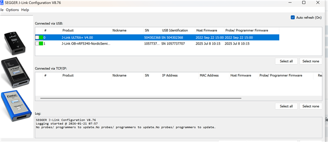

starting from ncs 3.2.0 (also in 3.2.1) when i attached the debugger (jlink ultra+, under VS code with nrf connect extension) to my nrf52833 board, i am getting the following error on RTT (on ncs 3.1.1 do not have such problem):
