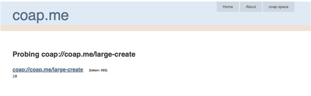

To further evaluate the feasibility of transmitting large payloads over CoAP with OpenThread, I looked into the block-wise transfer implementation, since this is the recommended approach for large payloads to avoid IPv6 fragmentation due to the small MTU size of IEEE 802.15.4. Since I need to send a payload of up to 2,450 bytes, using a block size of 64 bytes would require transmitting approximately 40 blocks.
To test this, I used the following command:
$ ot coap put <synthesized IPv6 address> <uri> block-64 40
From the documentation, this command will transmit 40 data blocks of 64 bytes each to the CoAP server. However, no payload ever arrives at my CoAP server. From the Graylog logs, it appears that the server is trying to parse the value 40 as the payload, even though in this command 40 is intended to represent the number of blocks to send, with the actual payload consisting of random bytes. Is the block-wise implementation in OT-CLI working as expected?

    I reproduced your issue with block-wise transfers and confirmed that the block count parameter was being treated as the payload.
    When building the sample, you are using the prebuilt OpenThread library, so the configuration changes are not applied. Block-wise CoAP is not enabled by default so it fails.
    To fix this:
    Enable block-wise CoAP support:
    CONFIG_OPENTHREAD_COAP_BLOCK=y
    This maps to:
    OPENTHREAD_CONFIG_COAP_BLOCKWISE_TRANSFER_ENABLE
    Force OpenThread to rebuild by enabling:
    CONFIG_OPENTHREAD_SOURCES=y
    After enabling both options and rebuilding, block-wise transfers work correctly. I was able to send a request successfully using:
    ot coap post <synthesized IPv6 address> <uri> block-64 8
    For the last question. You should rely on the Zephyr CoAP API as described in these docs, this requires no changes as this is the default. The docs also describes the pros and cons of each approach.
