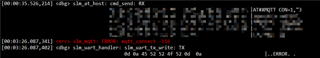

    Normally, when the nrf52840 sends an MQTT connection request (AT#XMQTTCON=1), if incorrect broker parameters are configured, modem_cmd_send() will return the result after the timeout period. However, through my testing, I found that if the timeout is set to more than 170 seconds, modem_cmd_send() will only return after 170 seconds.
