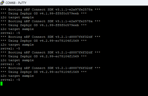

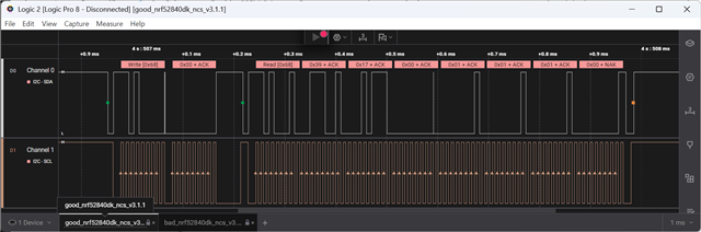

On ncs v3.1.1, one observes that the 52840 correctly writes the byte 0 to device 0x68, performs an I2C restart, and then reads 7 bytes of calendar data:

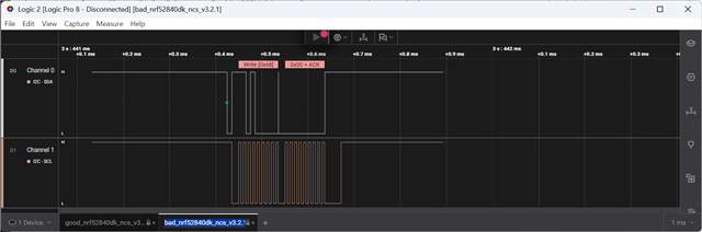

On ncs v3.2.1 and v3.2.0, one observes that the 52840 correctly writes the byte 0 to device 0x68, performs an I2C restart, and then terminates with retval=-5 (not clocking the read operation).

  • I think I have the same issue on SDK 3.2.1. I'm trying to complete the nRF Connect SDK Fundamentals lesson 6 exercise 1, and it's failing. My logic analyzer shows almost identical to yours. Address and single byte written get ACK, and then it returns with an error code, and lets the bus rise into "inactive" (no stop bit, no restart attempt).
    I tried adding debugging I2C with CONFIG_I2C_LOG_LEVEL_DBG=y which didn't give me answers. I tried disabling the SPI interfaces, I tried both I2C0 and I2C1 with no change. I ensured there are no device tree IO pin conflicts with the I2C pins. I tried i2c_write_read_dt (from the exercise) as well as i2c_write_dt, and both look good on the logic analyzer (including ACK), but both missing the restart/stop. I tried on both an nRF52832 and nRF52840. I even tried skipping the zephyr I2C drivers and configuring the registers directly with nrfx_twim_init, nrfx_twim_enable, and nrfx_twim_xfer.
