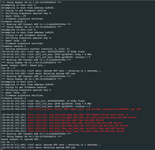

We're coming to the end of prototyping a project on the Thingy91X and are fine-tuning the power management.  We have been able to implement a simple demo on the nrf9151dk and wanted to port this to our own code on the Thingy91X.  Although very simple, the code creates some odd behaviour which I'd be grateful if someone could explain to me.  The code should put the device into System OFF then wake it from the user button (P0.26).  This works perfectly on the nRF9151 using Button 1 and 2 (Pins 8 and 9).  The Thingy, however produces wifi related errors on almost every second shutdown and fails to register the the button as the wake up cause also 50% of the time.  Any ideas what is going on here:

Output:
*** Booting nRF Connect SDK v3.1.0-6c6e5b32496e ***
*** Using Zephyr OS v4.1.99-1612683d4010 ***
Attempting to boot slot 0.
Attempting to boot from address 0x8200.
I: Trying to get Firmware version
I: Verifying signature against key 0.
I: Hash: 0x3e...f9
I: Firmware signature verified.
Firmware version 2
[00:00:00.254,211] <inf> spi_nor: GD25LE255E@0: 32 MiBy flash
[00:00:00.306,945] <inf> wifi_nrf_bus: SPIM spi@b000: freq = 8 MHz
[00:00:00.313,568] <inf> wifi_nrf_bus: SPIM spi@b000: latency = 0
[00:00:00.325,408] <err> wifi_nrf_bus: Error: RPU comms test: sig failed: expected 0x42000020, got 0x0
[00:00:00.335,540] <err> wifi_nrf: zep_shim_bus_qspi_dev_add: RPU enable failed with error -1
[00:00:00.344,879] <err> wifi_nrf: nrf_wifi_bus_qspi_dev_add: nrf_wifi_osal_bus_qspi_dev_add failed
[00:00:00.354,675] <err> wifi_nrf: nrf_wifi_bal_dev_add: Bus dev_add failed
[00:00:00.362,426] <err> wifi_nrf: nrf_wifi_sys_hal_dev_add: nrf_wifi_bal_dev_add failed
[00:00:00.371,368] <err> wifi_nrf: nrf_wifi_sys_fmac_dev_add: nrf_wifi_sys_hal_dev_add failed
[00:00:00.380,615] <err> wifi_nrf: nrf_wifi_fmac_dev_add_zep: nrf_wifi_fmac_dev_add failed
[00:00:00.389,648] <err> wifi_nrf: nrf_wifi_if_start_zep: nrf_wifi_fmac_dev_add_zep failed
Reset reason: 4, System OFF..
Pin 26 - 1
[00:00:00.411,132] <inf> main: System OFF test - entering in 2 seconds...
[00:00:02.418,518] <inf> main: Entering System OFF now
I: Hash: 0x3e...f9
Firmware version 2
[00:00:00.306,976] <inf> wifi_nrf_bus: SPIM spi@b000: freq = 8 MHz
[00:00:00.313,598] <inf> wifi_nrf_bus: SPIM spi@b000: latency = 0
Pin 26 - 0
[00:00:00.535,308] <inf> main: System OFF test - entering in 2 seconds...
[00:00:02.542,694] <inf> main: Entering System OFF now
I: Hash: 0x3e...f9
Firmware version 2
[00:00:00.254,241] <inf> spi_nor: GD25LE255E@0: 32 MiBy flash
[00:00:00.307,006] <inf> wifi_nrf_bus: SPIM spi@b000: freq = 8 MHz
[00:00:00.313,629] <inf> wifi_nrf_bus: SPIM spi@b000: latency = 0
[00:00:00.325,469] <err> wifi_nrf_bus: Error: RPU comms test: sig failed: expected 0x42000020, got 0x0
[00:00:00.335,601] <err> wifi_nrf: zep_shim_bus_qspi_dev_add: RPU enable failed with error -1
[00:00:00.344,940] <err> wifi_nrf: nrf_wifi_bus_qspi_dev_add: nrf_wifi_osal_bus_qspi_dev_add failed
[00:00:00.354,766] <err> wifi_nrf: nrf_wifi_bal_dev_add: Bus dev_add failed
[00:00:00.362,487] <err> wifi_nrf: nrf_wifi_sys_hal_dev_add: nrf_wifi_bal_dev_add failed
[00:00:00.371,429] <err> wifi_nrf: nrf_wifi_sys_fmac_dev_add: nrf_wifi_sys_hal_dev_add failed
[00:00:00.380,706] <err> wifi_nrf: nrf_wifi_fmac_dev_add_zep: nrf_wifi_fmac_dev_add failed
[00:00:00.389,709] <err> wifi_nrf: nrf_wifi_if_start_zep: nrf_wifi_fmac_dev_add_zep failed
Pin 26 - 1
[00:00:00.411,224] <inf> main: System OFF test - entering in 2 seconds...
[00:00:02.418,609] <inf> main: Entering System OFF now
I: Hash: 0x3e...f9
Firmware version 2
Pin 26 - 0

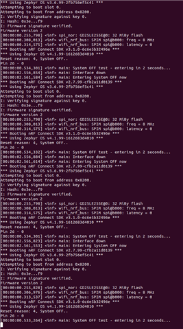

    Thank you for clarifying.
    andychess said:
    If the shutdown routine included in the sample I posted, requires additional steps to shutdown and or start the RPC, please let me know, so that we can test further.
    Shutting down the Wi-Fi interface before entering system off should fix the issue:
    You can shut down the Wi-Fi interface with net_if_down():
    int shutdown_wifi()
    	int ret;
      struct net_if *iface = net_if_get_default();
    	if (!net_if_is_admin_up(iface)) {
    		return 0;
    	ret = net_if_down(iface);
    	if (ret) {
    		LOG_ERR("Cannot bring down iface (%d)", ret);
    		return ret;
    	LOG_INF("Interface down");
    	return 0;
    Then call this function before NRF_REGULATORS->SYSTEMOFF = 1.
    Make sure to include the net_if file so that you can use net_if_down():
    #include <zephyr/net/net_if.h>
    Marte
