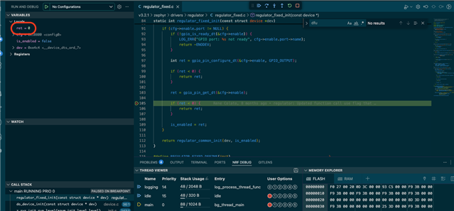

    I did not have any luck replicating the issue. In my case it is always being read as '0' as you can see from the screen dump below. This was tested on a nRF54L15 DK with SDK v3.2.1.
    I also find it strange that we are trying to read the GPIO input right after we have configured it as an output. The gpio_pin_get_dt() will read the GPIO.IN register which is only valid when the pin is configured as an input. Perhaps it works differently on other platforms.
    Attached is the sample I used for test, perhaps you could have a look at it to see if we are doing anything differently?

  • Thanks, I see the same thing. Both your example and our project behave fine on the nrf54l15 dk. This may be some sort of hardware issue on our end. But to your point, what's in the GPIO.IN if the pin is set to output? How/why could it read 1 after configuring it as an output? Is it possible there's some pull up or capacitance? Anything happens on the GPIO during config?
    If you agree that zephyr's driver is incorrect, even if it seems to result in correct behavior on the dk, what/how should that be addressed?
    Update: after speaking with our HW eng, we identified that the pull-up and decoupling cap on that regulator line were causing this issue. It seems that configuring the pin as the output briefly pulls up the line and GPIO.IN reads 1 for a few milliseconds. When we removed the pull-up and the capacitor, that issue went away. It seems that even if the pin is not set to input, the GPIO.IN register does do something.
    So the takeway is that if any customers are using fixed regulator with a pull-up/decoupling cap config, they can not use current zephyr regulator driver. Is that accurate?
