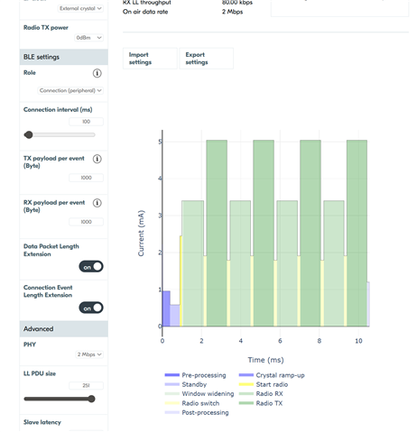

    A connection interval of 7.5ms is too short. It gives a too high header/payload throughput ratio. Check out the throughput sample (and try with 7.5ms as well, to verify). You can also see, if you experiment with the online power profiler, that setting the connection interval = 7.5ms, and setting a high data throughput will use more than 7.5ms per connection interval:
    I believe the optimal connection interval is roughly 100-150ms, where you should see (in a quiet environment) you should see a throughput close to the theoretical maximum, somewhere between 1.3 and 1.4 Mbps.
