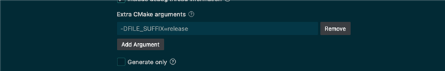

DFU should be enabled by default if you select the "release" configuration. Did you try that?
Hi Vidar,
With this change it build successful, but when i tried to do dfu with generated dfu_application.zip, it is failing in eneabling bootloader. I have tested with DFU and Device manager apps in both app it is failing in bootloader enable.

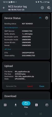

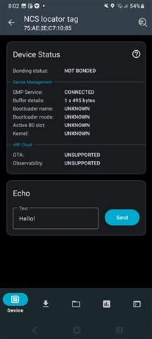

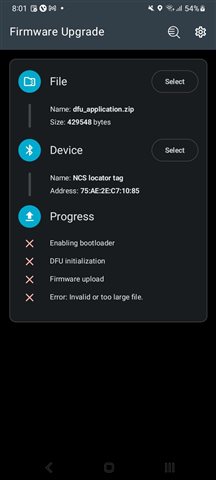

Hi Vidar,
Please find attached screenshot of DFU and Device manager app.
It is failing in bootloader enable in both app.
The dfu app shown in the second picture is only supporting legacy dfu. You need to use either the device manager or nrf connect app. Also, the first image from det device manager app is not showing any attempts to upload the fw
