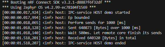

Flashing error with Zephyr icmsg sample on nRF54L15-DK (M33 <-> RISC-V)
I am trying to run the Zephyr icmsg sample on the nRF54L15-DK. My goal is to establish communication between the M33 core and the RISC-V core.
https://github.com/zephyrproject-rtos/zephyr/tree/main/samples/subsys/ipc/ipc_service/icmsg
The build process completes successfully, but I encounter an error when flashing the board.
Could you please let me know if there are any possible causes or solutions for this issue?
*** Booting nRF Connect SDK v3.2.1-d8887f6f32df ***
*** Using Zephyr OS v4.2.99-ec78104f1569 ***
[00:00:00.002,174] <inf> host: IPC-service HOST demo started
[00:00:00.002,194] <err> os: ***** BUS FAULT *****
[00:00:00.002,199] <err> os:   Precise data bus error
[00:00:00.002,203] <err> os:   BFAR Address: 0x5004c304
[00:00:00.002,214] <err> os: r0/a1:  0x00000000  r1/a2:  0x00000014  r2/a3:  0x00100000
[00:00:00.002,221] <err> os: r3/a4:  0x5004c000 r12/ip:  0x20002f1c r14/lr:  0x0000244b
[00:00:00.002,226] <err> os:  xpsr:  0x09000200
[00:00:00.002,230] <err> os: Faulting instruction address (r15/pc): 0x0000b7e2
[00:00:00.002,249] <err> os: >>> ZEPHYR FATAL ERROR 25: Unknown error on CPU 0
[00:00:00.002,266] <err> os: Current thread: 0x20000a68 (main)
[00:00:00.079,072] <err> os: Halting system

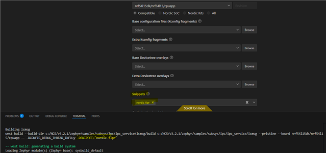

Building icmsg_12
west build --build-dir c:/boards/test/icmsg_12/build c:/boards/test/icmsg_12 --pristine --board nrf54l15dk/nrf54l15/cpuapp -- -DCONFIG_DEBUG_THREAD_INFO=y

I have attached the build and flash logs below.
