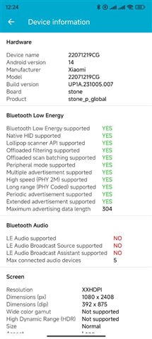

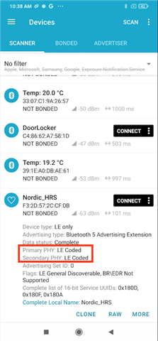

NRF Connect does not see advertising packages for coded mode
I took the example of peripheral_hr_coded and central_hr_coded. I flashed these examples in nrf52840. They communicate normally. However, the Advertising Packages are not visible in NRF Connect.
Can you tell me if I have configured something incorrectly?
