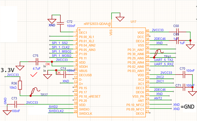

my nrf52833 board cannot start (reset ) normally
my nrf52833 board cannot work after power. but can start when I run nrfjprog --reset .
but when I power down and power on the nrf52833 board, it do not work.
the following is my board. (No nfc)
please check and tell me .  what caused the reset issue (power off and power on cannot start<boot> the board )
thanks。
    The nRF has an internal pullup on the reset line, and does not need a resistor on it. Can you remove R36 and try again?
  • I try and remove this pullup resistor. the observation is just the same.

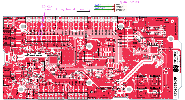

    my swd and swsck is connected to DK pin
    vs code <------> 52833DK <------>my board.
    would you please tell me how can I handle this 19,20pin (swdio,swdsck)?
    would you please give me reference design for SWD interface?
  • Did nrfjprog --reset broke after you removed the resistor, or was it the same before?
    Here is a post about using the devkit with an external board: https://devzone.nordicsemi.com/f/nordic-q-a/102480/how-to-program-an-external-board-using-a-dk-board
    Please also try to connect to the target with J-Link commander.
  • I do have 10K pull up resistor。
    the same thing .
    I can debug only once. If i need debug again. I must repower and recover reset it again.
    my package is QDAA(40pin). different from DIAA(DK)
    QFN40 is different from other package?
    my code and proj.cnf works well for DK (pin73).
    the package is only a difference in pin count, the chip inside is the same.
    So you can always connect after a recover, and then cannot connect after programming the chip. This tells me that you have a configuration in your project which disabled the debug interface. What project are you flashing on the board? Does this issue occur if you try with another firmware?
