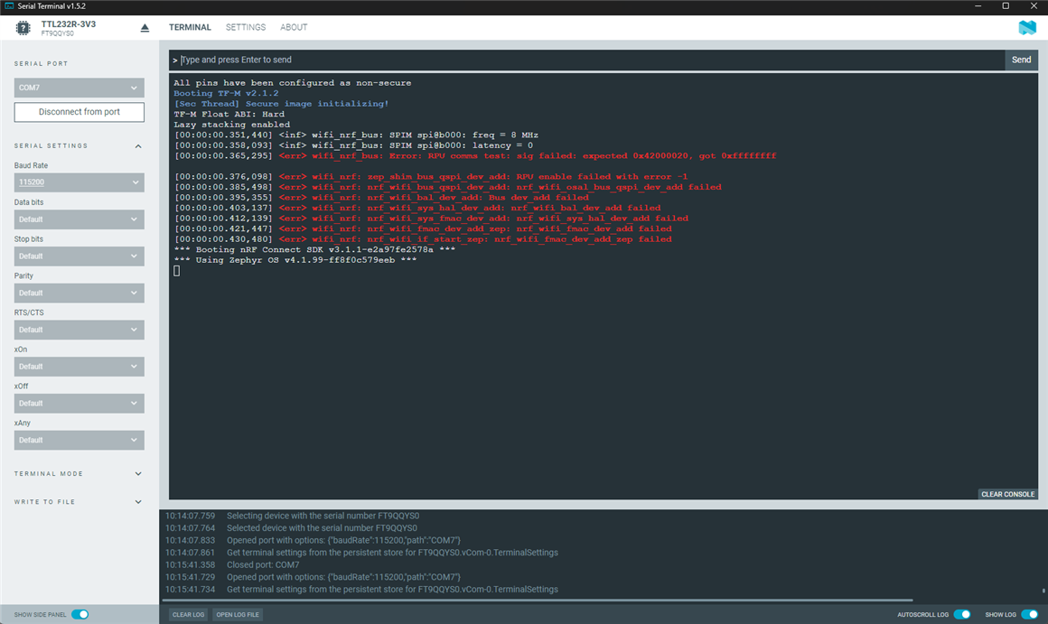

At the moment, the board is powered from a 5 V USB-C connector. When I turned on switch SW1 first, the following error message appeared:

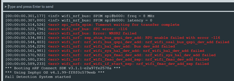

After increasing the default current limit of 100 mA of the nPM1300 to 500 mA, the original error was resolved. However, this change resulted in the following new error:

I realized that I did not route the IOVDD supply through a GPIO-controlled power switch from the host. Instead, IOVDD is applied immediately when SW1 is turned on. This violates the recommended power-up sequence. For my pin-ctrl gpio i am currently using GPIO P0.20 of the nrf9151 which is not routed.
My question is whether the missed boot up sequence could be the root cause of the observed error, or if there are other possible reasons that could lead to the same behavior. Since fixing the IOVDD sequencing would require hardware modifications (cutting traces and adding a switch), I would like to rule out any other potential sources of error before making such changes.
