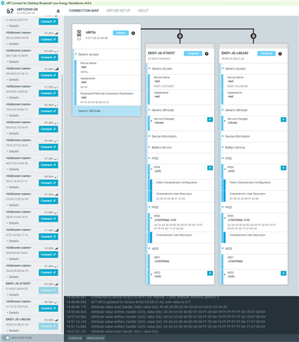

  • Thank you for your previous response and suggestions. I've implemented all of them as best as I could with the available hardware, but I'm still facing issues with connecting to the second lamp reliably. The application works perfectly for a single lamp (connects, discovers FFE9, sends commands), but for two lamps, it either connects to only one or fails with MTU exchange err 14 and disconnect reason 62. The lamps work fine with an ESP-32D (both sequentially and concurrently), so environmental factors like RF noise are unlikely the cause. Also the DK connects and sends commands to both of the lamp correctly via Nordic Bluetooth Low Energy app.
    Analysis of What I've Tried Since Your Response:
    • Increased CONFIG_BT_MAX_CONN to 3: Set in prj.conf (attached) — no change, still only one connection succeeds.
    • Set CONFIG_BT_CTLR_SDC_PERIPHERAL_COUNT=0: Set in prj.conf — no improvement in multi-central stability.
    • Test with DKs as peripherals: I don't have three DKs, but tested with the available hardware (nRF52840 DK as central, lamps as peripherals). The lamps are third-party, but their ads are visible in sniffer captures (both MACs advertise normally).
    • nRF Sniffer: Set up on a dongle/Feather, captured traffic — shows both lamps advertising (ADV_IND with service UUID FFE5), but the DK only sends CONNECT_REQ to one. No CONNECT_REQ to the second, even though ads are received. MTU exchange fails on the first with "Unlikely Error" (0x0E).
    • Multi-NUS repo/post: Reviewed the multi-NUS GitHub repo and post — implemented similar concurrent central logic with separate conn objects, increased buffers (L2CAP, ACL, CONN_TX_MAX), but still MTU failure and only one connection.
    • Additional steps I tried:
      • Sequential cycling (connect1 → write → disconnect → connect2 → write → disconnect → repeat) — connects to one random lamp per reset, sends commands, but doesn't cycle to the second.
      • Skipped MTU exchange — writes fail with -12 (ENOMEM) or no ATT channel.
      • Dummy write to FFE9 for BT icon — works for one lamp.
      • Swapped MAC types (public/random) — no change.
      • Increased scan interval/window — catches ads, but connect only to one.
