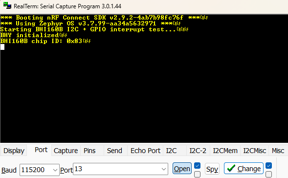

We are working with nRF52840 MCU with zephyr v2.9.2 SDK and Visual Studio IDE for debugging, Flashing, Generating zephyr.uf2 file. We took one example have configured the I2C driver (I2C pins 04,05 in .overlay file) for BHI160B IMU and GPIO expander data.
First we developed our application using nRF52840 DK board and it is working as expected after we generated zephyr.uf2 file by modifying the build configurations for Seeed Studio xiao_nrf52840 board and tested. We successfully completed the .uf2 file flash in Seeed Studio xiao_nrf52840. When we reset the board it only shows the device ID of BHI160B IMU as 0x83. But unable to write the Firmware to IMU & getting failed at initial stage only.
Please go through the below information and suggest to get the data from the BHI160B IMU using Seeed Studio xiao_nrf52840. I would appreciate to the help provided for below

1. I have added below in the .overlay file
&i2c0 {
    status = "okay";
    pinctrl-0 = <&i2c0_default>;
    pinctrl-1 = <&i2c0_sleep>;
    clock-frequency = <I2C_BITRATE_FAST>;
    bhi160b: bhi160b@29 {
        compatible = "bosch,bhi160b";
        reg = <0x29>;
        label = "BHI160B";
        int-gpios = <&gpio1 15 GPIO_ACTIVE_LOW>;
        status = "okay";
&pinctrl {
    i2c0_default: i2c0_default {
        group1 {
            psels = <NRF_PSEL(TWIM_SDA, 0, 26)>,
                    <NRF_PSEL(TWIM_SCL, 0, 27)>;
    i2c0_sleep: i2c0_sleep {
        group1 {
            low-power-enable;
2. This is the main.c file having IMU initialization and Data reading in while code

3. please go through the attached output image of Sl#2 code.
4. I am using below print for data reading but in Sl#3 I did not observe as expected.
printk("Roll %2.2f, Pitch %2.2f, Yaw %2.2f\n", euler1[ROLL], euler1[PITCH], euler1[YAW]);
