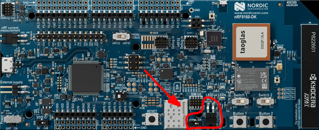

  • Hi Adam,
    First thing you can check is if the board is configured correctly. Does it have the "SIM current measurement" jumper (P30) on, and is the "SIM select" switch (SW7) on "SIM" (even tho iBASIS call their cards "eSIM", they are normal SIM cards. eSIMs are an electronic chip that you solder to your board. wikipedia link).

  • Does it have the "SIM current measurement" jumper (P30) on,
    Ahhh, that was the issue. Thanks Simon, I was losing my mind over this during the weekend.
