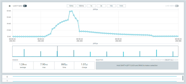

  • Hello team,
    I am characterizing the power consumption of a custom embedded board using the NRF Power Profiler Kit 2 (PPK2) and the nRF Connect for Desktop Power Profiler app (v4.3.1).
    Setup Configuration:
    • Mode: Ammeter Mode
    • Power Source: External 3.6V 9Ah Battery
    • Hardware: Custom board (microcontroller-based)

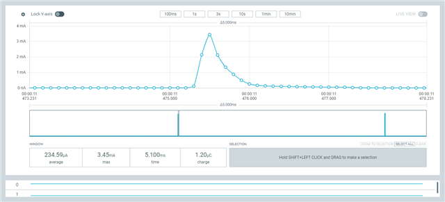

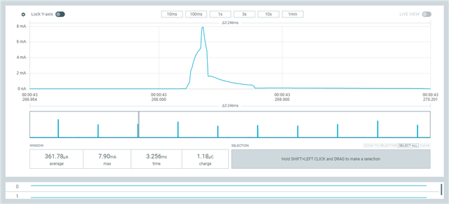

    Observation: I am seeing a consistent current spike for every 16 seconds. However, the reported peak magnitude of this spike changes drastically depending on the selected sampling rate in the app:
    • 100k samples/s: Sudden Peak current = 8mA(every 16 seconds and peak lasts for 200microsecond)
    • 10k samples/s: Sudden Peak current = 4mA(every 16 seconds and peak last for 1millisecond)
    • 1k samples/s: Sudden Peak current = 0.9mA.
    Questions:
    1. Is this variance purely due to the sampling interval missing the peak of a high-speed pulse (aliasing/averaging), or is there an internal filtering mechanism in the PPK2 software that scales based on the sampling rate?
    2. Given the 16-second regularity, are there known internal nRF Connect or PPK2 calibration routines that occur at this interval, or should I focus entirely on my firmware/hardware of  my custom board?
    Any insights on how to properly interpret these discrepancies for a professional power report would be appreciated.For your referene i have attached image below for different sample test.

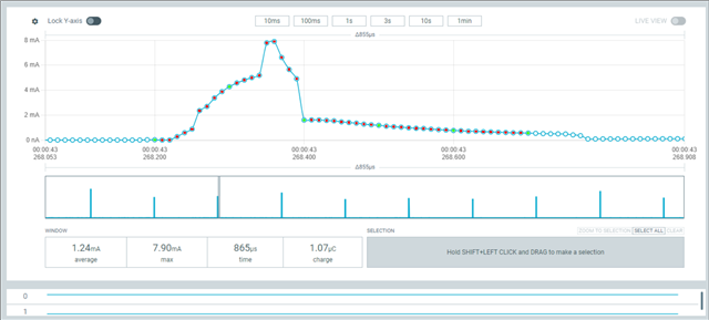

  • Hi Jameson,
    Yes, I strongly believe that what you are seeing here is due to under-sampling. You can most likely trust 100k sample/sec measurement.
    You can see in this picture that if you highlight one sample every 10 samples you get a wave that is way closer to the one you measure at 10k samples/sec.
