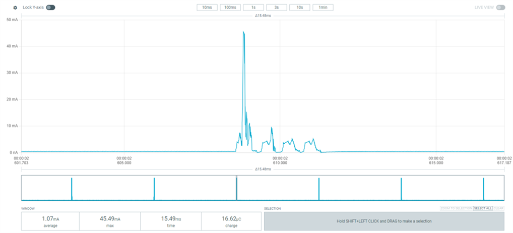

on the PTX side, I am measuring the current using the PPK2, we cut the link with PRX to see the current for packet retransmissions also. Current shows a strong peak of 45 mA (main TX transmission) followed by very weak peaks of 5 mA related to packet retransmission.
My question is: why does the current drops for packet retransmissions ? Does it mean that emission power is lower and the range is compromised when packets are retransmitted ?
Here is a screen shot of the current with the BT840NE :

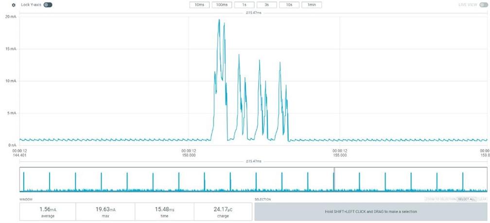

When I use the Nordic nRF21540-DK I get another behavior (more reasonable levels) with a first peak of 20 mA and retransmissions peaks of 15 mA as shown in the following screen shot :

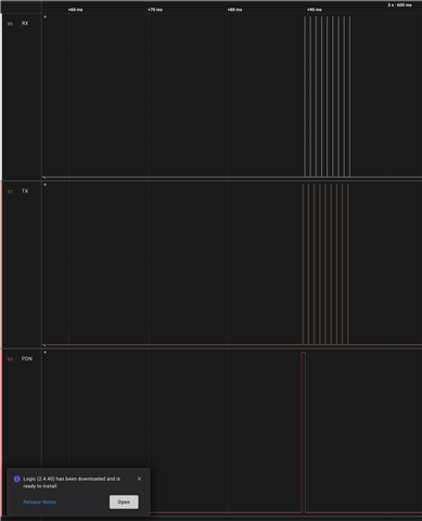

    Thank you for sharing this information. I have been able to reproduce the scenario, and it looks like the issue is related to how esb handles re-transmissions when FEM is enabled.
    Looking at the PDN pin of the nRF21540, it indicates that the subsequent re-transmissions are not enabling the FEM:
    I have reported this internally to the ESB team.
    Calling "mpsl_fem_enable()" in esb.c::on_radio_disabled_tx_wait_for_ack() seems to fix the issue, but I cannot guarantee that this is does not have any unforeseen side-effects at this point.

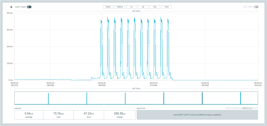

    Thanks for your quick response.
    What you suggested worked, here is the new ppk2 current measurement, both the main transmission and retransmissions are at the same current levels :
    Yanis
