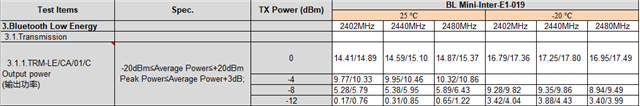

        Our product uses the nRF52840. During CE certification, the lab measured the  BLE TX power in DTM mode.  at –20 °C the power is 3–4 dB higher than at +25 °C. Could you help to check if Nordic provide a way to compensate the TX power so that it stays the same  TX power at different temperatures?
         The attachemnt picture is TX power test result of out product
