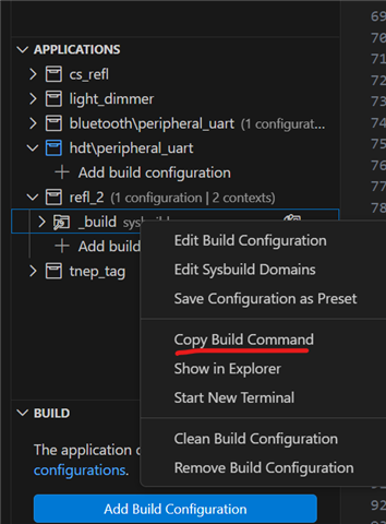

    Sorry for my previous reply. It was a bit off. It was originally intended for another ticket, and I thought it could be the same issue, as they were also trying to range between multiple reflectors/initiators (but alternating, by disconnecting from them).
    I tried to build your applications, but I couldn't. I got a build error. Can you please let me know what NCS version you are using, and what build command you are using. If you are using nRF Connect for VS Code, you can copy the build command by right clicking the build folder and select "Copy build command" in VS Code.
    And is my understanding correct:
    If I build your applications, flash the central_uart... to one nRF54L15 DK, and the reflector to two other nRF54L15 DKs, I should be able to see the issue that you are seeing?
    Edvin
  • Hi, Its okay,
    I have updated the code base now. I will share that with you.
    The build command I am using is
    west build --build-dir cs/central_uart --pristine --board nrf54l15dk/nrf54l15/cpuapp --sysbuild -- -DCONF_FILE="prj.conf" -DDEBUG_THREAD_INFO=On -DCONFIG_DEBUG_THREAD_INFO=y -Dcentral_uart_DEBUG_THREAD_INFO=On
    Yes, if you run the reflector and initiator with my code, you should be able to recreate the issue.
