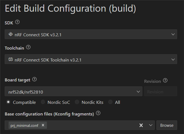

I bought both nrf52 DK with nrf52832 and ISC-nRF52810-A module. I use Visual Studio Code with nrf SDK + toolchain.
Hardware connection from ISC-nRF52810-A to nrf52 DK is as follows, (based on nrf52 DK User Guide 4.8.2)
  • P20-1 VDD_nRF to NC
  • P20-2 VDD to ISC-nRF52810-A VDD
  • P20-3 VTG to P1-VDD
  • P20-4 SWDIO to ISC-nRF52810-A SWDIO
  • P20-5 SWCLK to ISC-nRF52810-A SWCLK
  • P20-6 SWO to NC
  • P20-7 RESET to ISC-nRF52810-A RESET
  • P20-8 to P1-GND
  • P1-GND to ISC-nRF52810-A GND

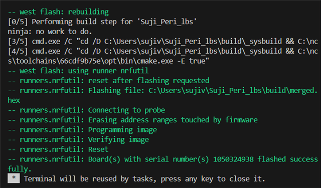

But whenever I flash the application, nrf52832 in the DK is getting flashed, even though the connected device in the GUI shows nrf52810.
Sample application: Peripheral LBS
Advance thanks for any help.
