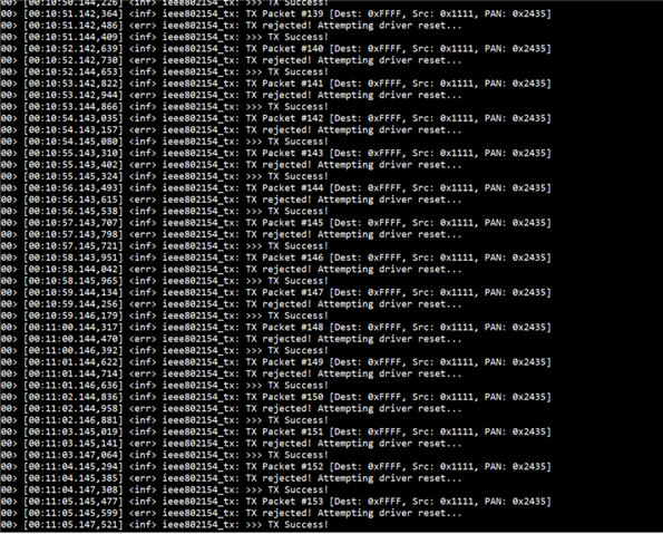

  • Hello.
    I understand that there is no official reference code available for this specific use case.
    As a first step, I am trying to implement periodic TX using IEEE 802.15.4 only, but even this basic periodic transmission is not working yet.
    If I upload the source code I have been working on, would it be possible to receive support or feedback on it?
    Ryan
  • You can upload it, and I can try to run it. Please let me know what NCS version you are using.
    Edvin
  • Hello.
    [My test Environment]
    boards: nRF52840DK
    SDK: ncs v3.1.2 Toolchain: v3.2.1
    The code below is a test application that periodically transmits 802.15.4 frames.
    It was written to send periodic broadcast packets (dst: 0xFFFF) without ACK, but no packets are actually transmitted and the transmit callback functions are never called.
    Ryan

    00> *** Booting nRF Connect SDK v3.2.1-d8887f6f32df ***
    00> *** Using Zephyr OS v4.2.99-ec78104f1569 ***
    00>
    00> ===========================================
    00> IEEE 802.15.4 TX Test - FINAL ATTEMPT
    00> NCS v3.2.1
    00>
    00> Init...
    00> Ready!
    00>
    00> TX #0: Queued...
    00> TIMEOUT
    00>
    00> TX #1: ERROR 1
    00>
    00> TX #2: ERROR 1
    00>
    00> TX #3: ERROR 1
    00>
    00> TX #4: ERROR 1
    00>
    00> TX #5: ERROR 1
    00>
    00> TX #6: ERROR 1
    00>
    00> TX #7: ERROR 1
    00>
    00> TX #8: ERROR 1
    00>
    00> TX #9: ERROR 1
    00>
    00> Stats: Success=0, Failed=0
  • Did you test the sample in my previous reply? Are you able to send the 0xFFFF packets there?
